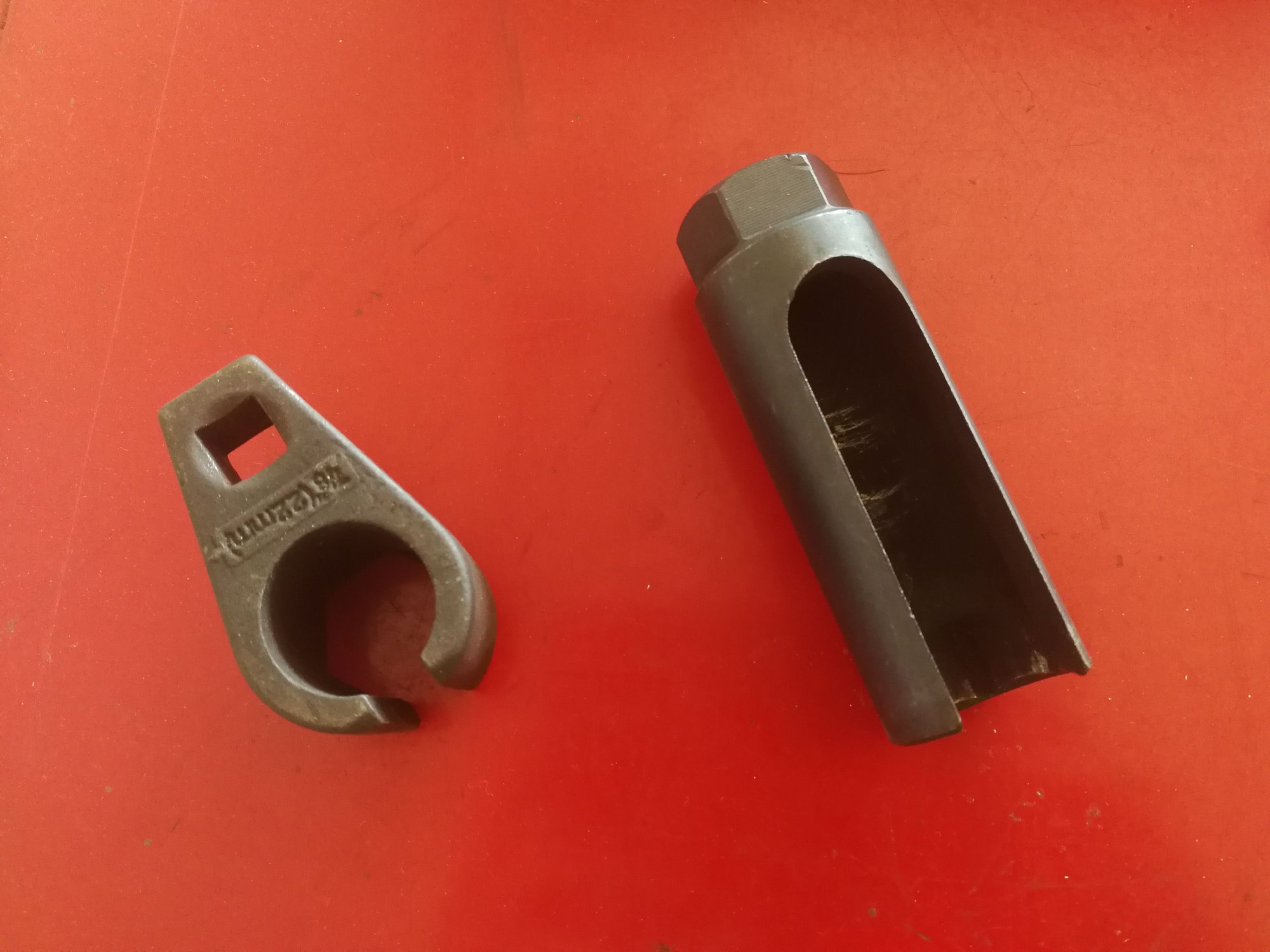

O2 sensor wrench or socket (see picture below)

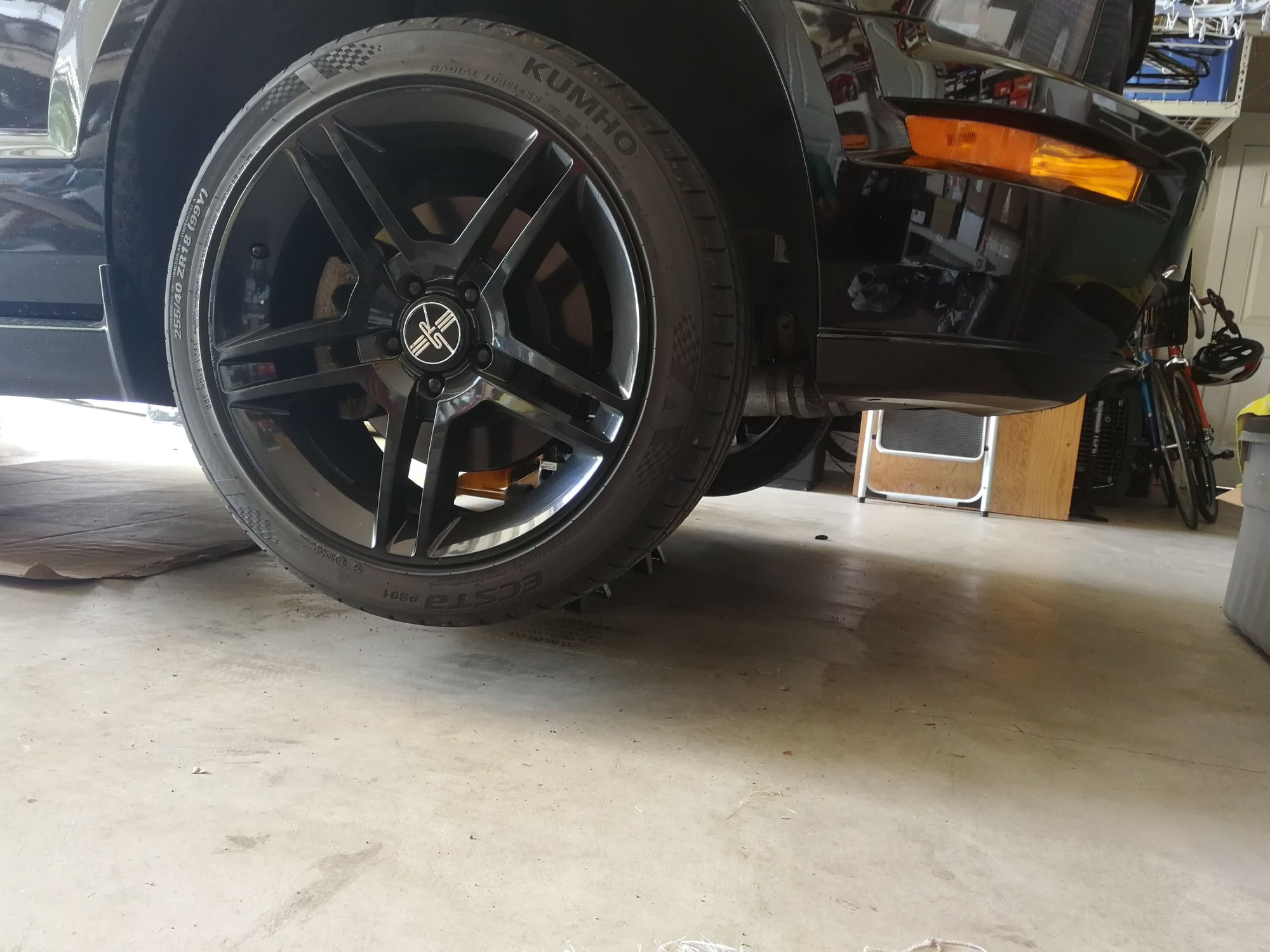

Make sure the car is in gear and e-brake is up. Jack up the front of the car.

Use the o2 sensor removal tool to unscrew your sensor. My picture isn't representative of your car but it gives you an idea.
