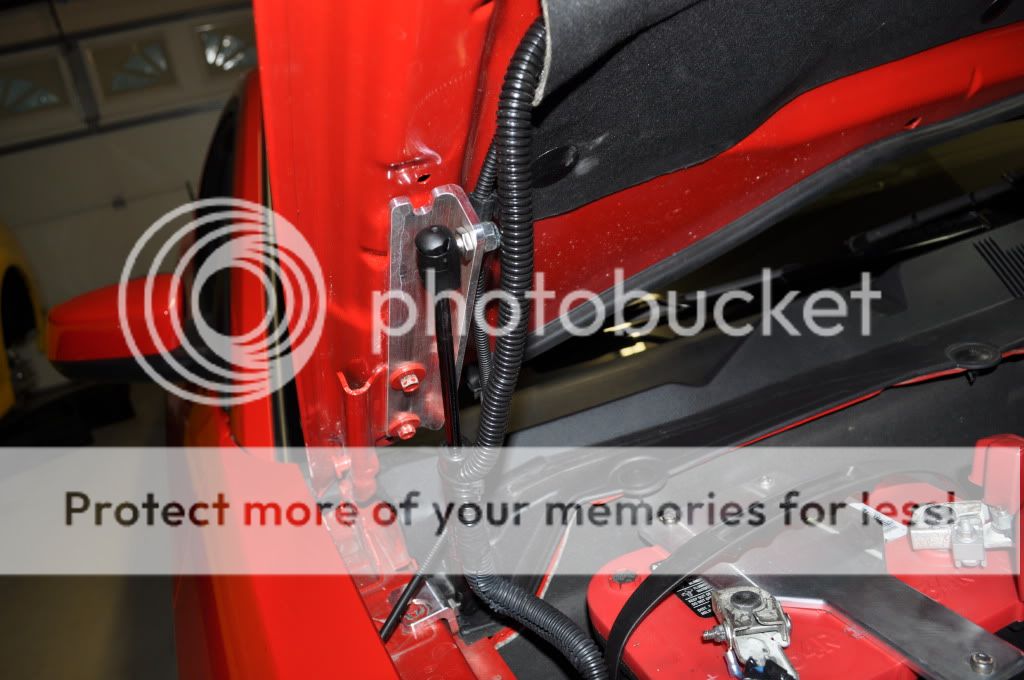

First locate the hood switch on the passenger side fender. This part of the security system and I assume all cars have this:
This switch has two wires: one in black the other is blue w/ a pink stripe. We will use the blue w/pink stripe wire to trigger our relay. The trigger wire is a reverse ground trigger and should be wired like this:
