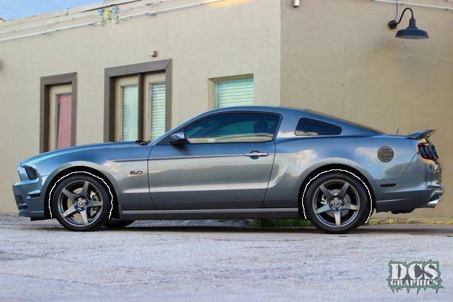

Here is a picture from a previous post I saw a while back with the stock 18 inch wheels on. The amount of rubber you see is exactly the same amount of rubber you should have on the new 18's. Look at the wheel gap from the top of the rubber to where the fender starts....
... Not the case in this photo (below). Basically the same shot, just zoomed out a little bit. You've got about a good 1-1/2 inches more wheel gap than you should that would be filled with the correct tire size on the new 18's. (This gap I'm talking about goes both ways, vertical and horizontal.) I know it's not the correct at least in the front because the gap is bigger in the front than it is in the back. Yes you have a fatter tire back there, but the gap in the front of that monster with a big V8 should be a lot smaller.
Now let's look at this side profile shot. Look at the rubber thickness. My friend has 20" wheels on his mustang and has more rubber than shown here. 18" wheels have a pretty decent amount of rubber. 19" wheels have less than 18", and 20" wheels have a little less than 19's and much less than 18's. If you looked at just the rubber here, it's less than the thickness on a normal set of 20's. One thing's for sure, she won't scrub when the wheel is cocked all the way left or right!
I'm glad you included this photoshop of what it would look like lowered. Sick btw! I'm not sure of the springs you have for this car, (I asked in a previous thread and never got an answer), but we are going to use Eibach Sportlines as an example. Just because I have them and I know them all too well. First, let's speak in terms of gap. With sportlines you're going to lose anywhere from 1.5-2 inches of actual gap. Sportlines are considered a more aggressive drop compared to the pro-kit and other springs on the market. Again, gap im talking about = the space between the top of the rubber to where the fender starts. On my car with 19" wheels, there's hardly a gap. I can fit 1 finger snug in between the gap up front and back. Because of the tire size you have on the 18's, she's still going to have a BIG gap than she normally would with the 'correct' 18" rubber size. To achieve the look you have in the photo above, she will need springs with at least a 3-3.5 inch drop. No spring set on the market has that sort of drop. She needs bags to achieve this (below)....and if she had the thicker rubber on, they would be tucked under the fender. Again this is hypothetically speaking.
(The white lines in this photo simulate where the rubber should extend to on an 18" wheel. Give or take a 1/8 of an inch.)
This is what it would look like if you hypothetically put on sportlines. You're back to a little less than stock gap. And this is because of the rubber size. If you had more rubber, that gap would then look like it does pictured in your photoshop.
