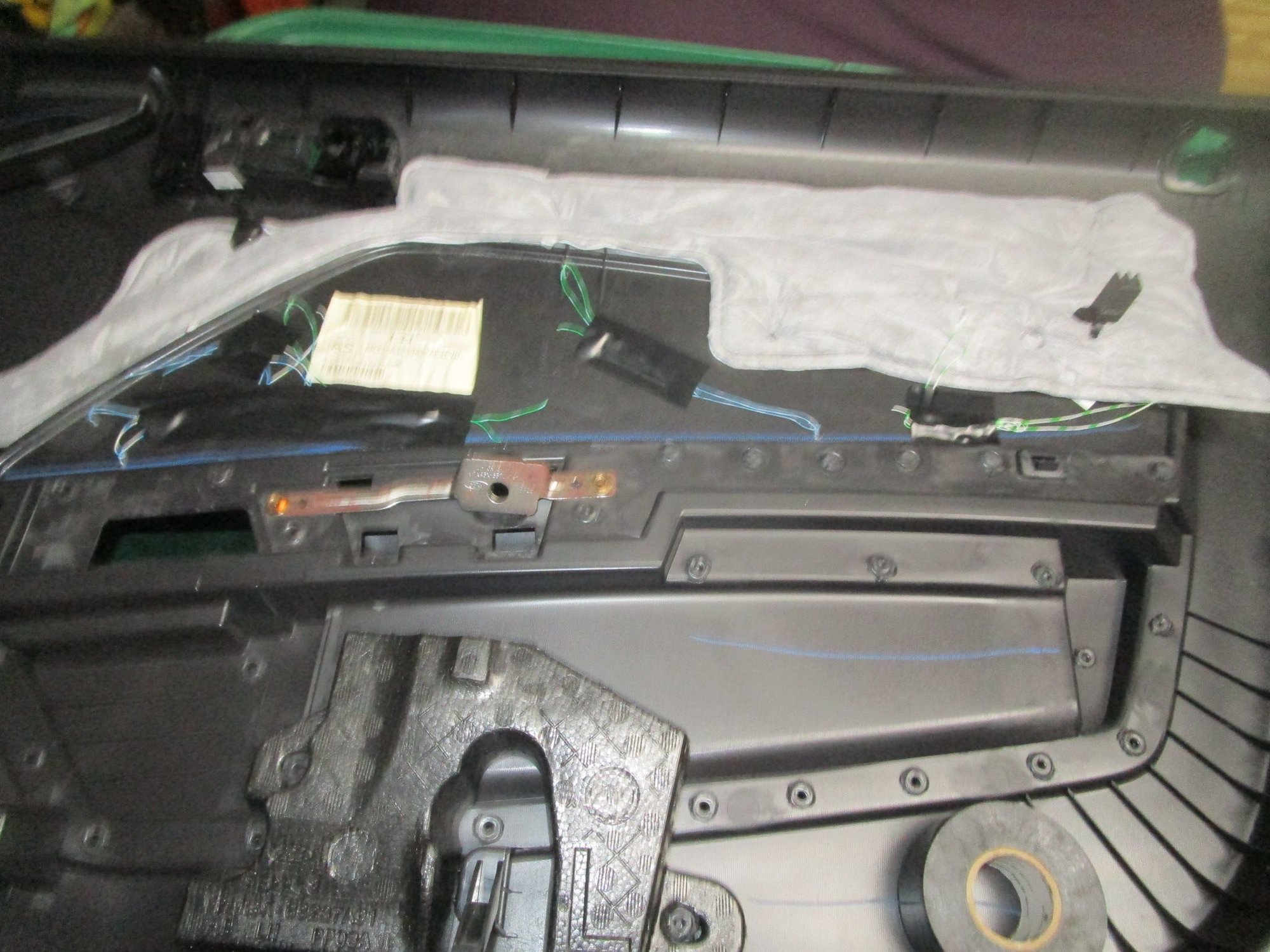

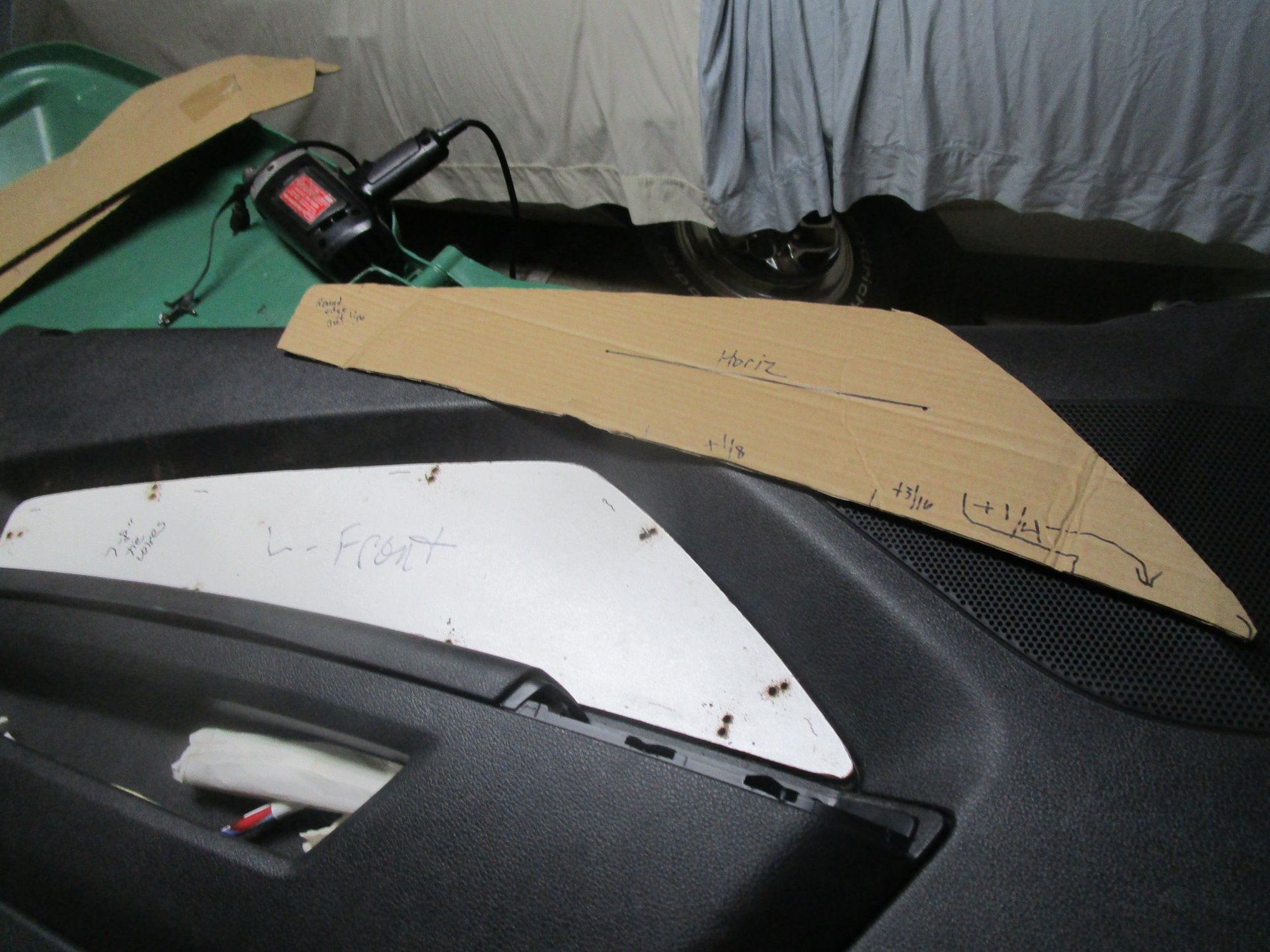

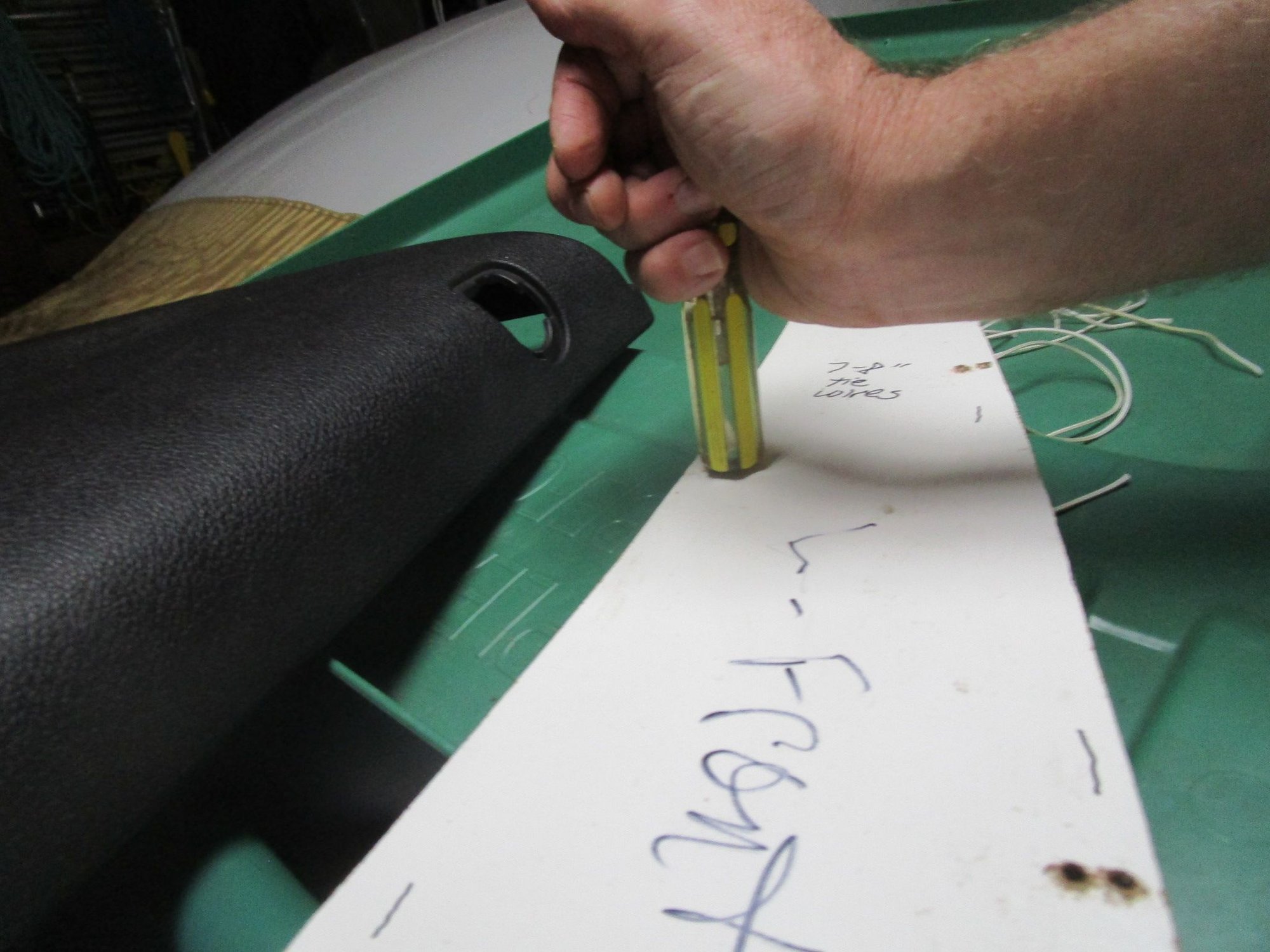

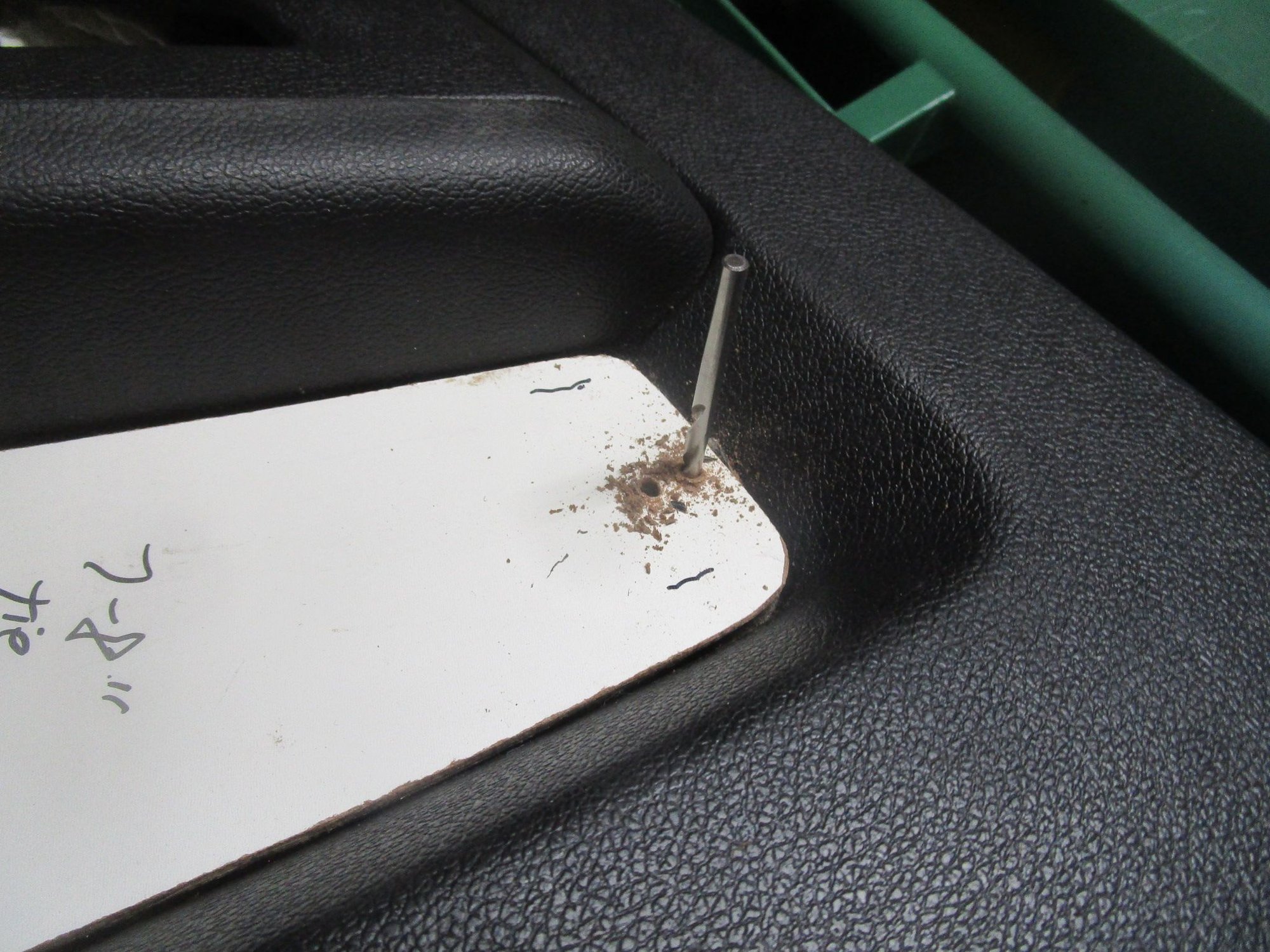

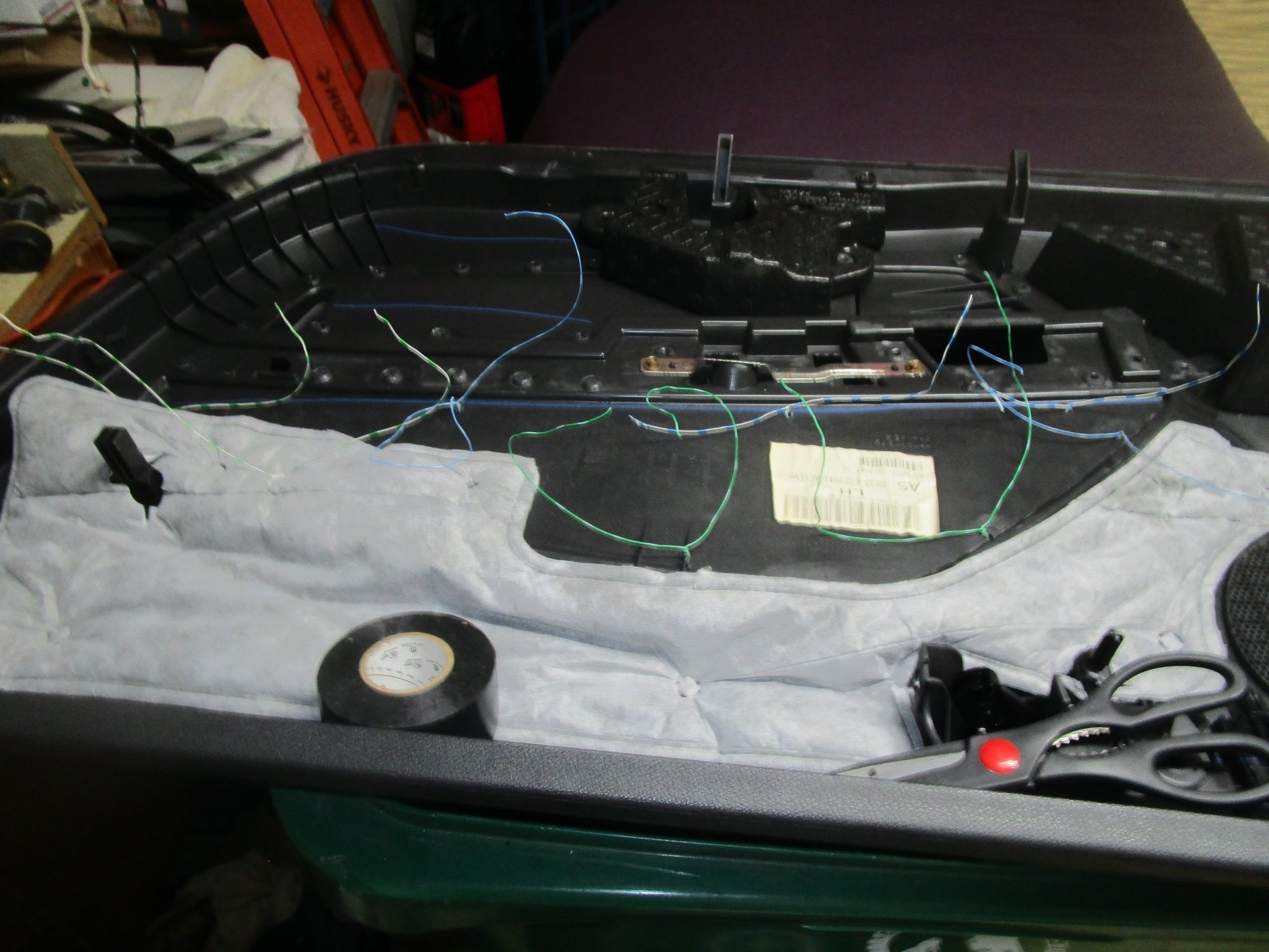

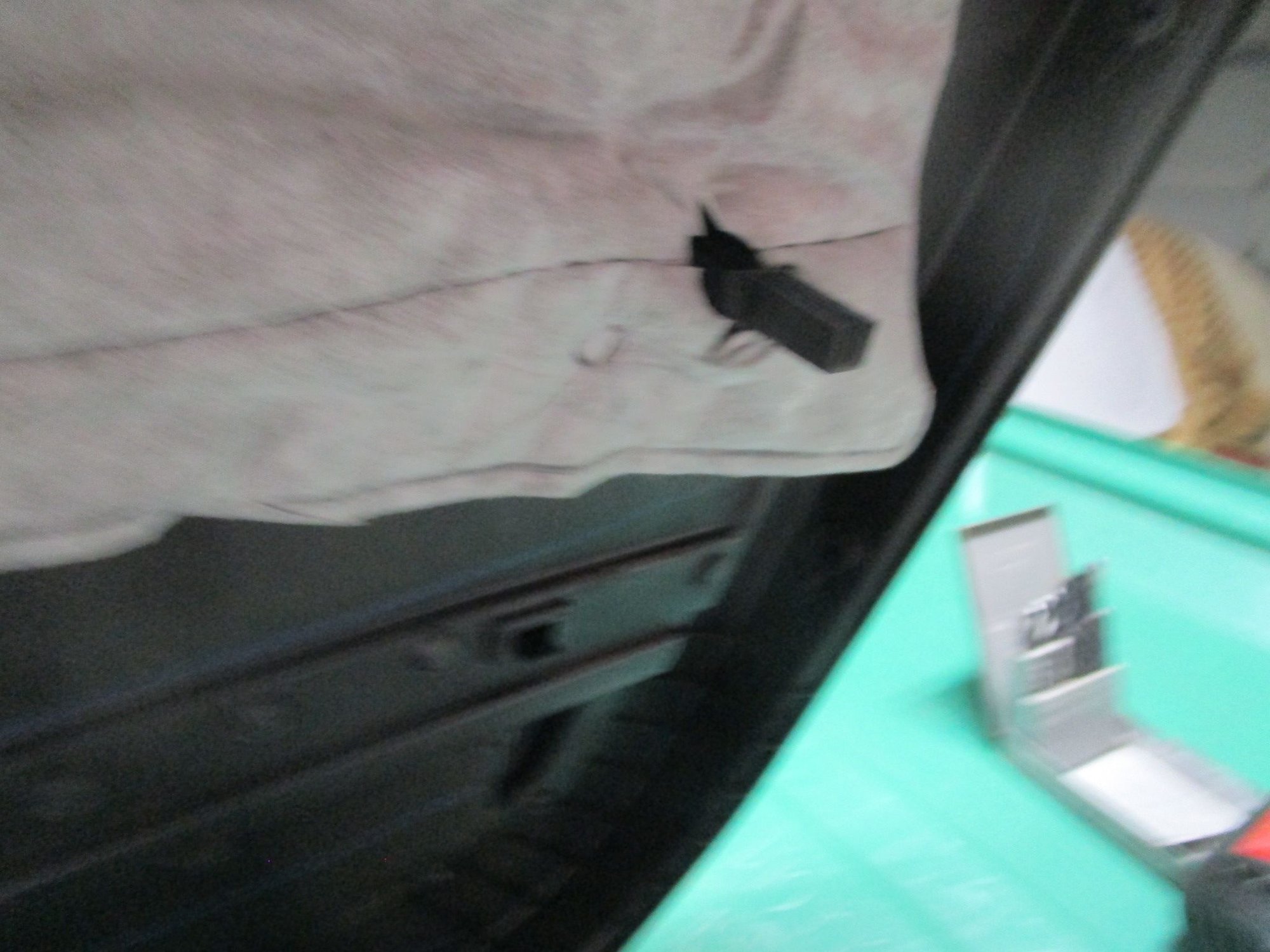

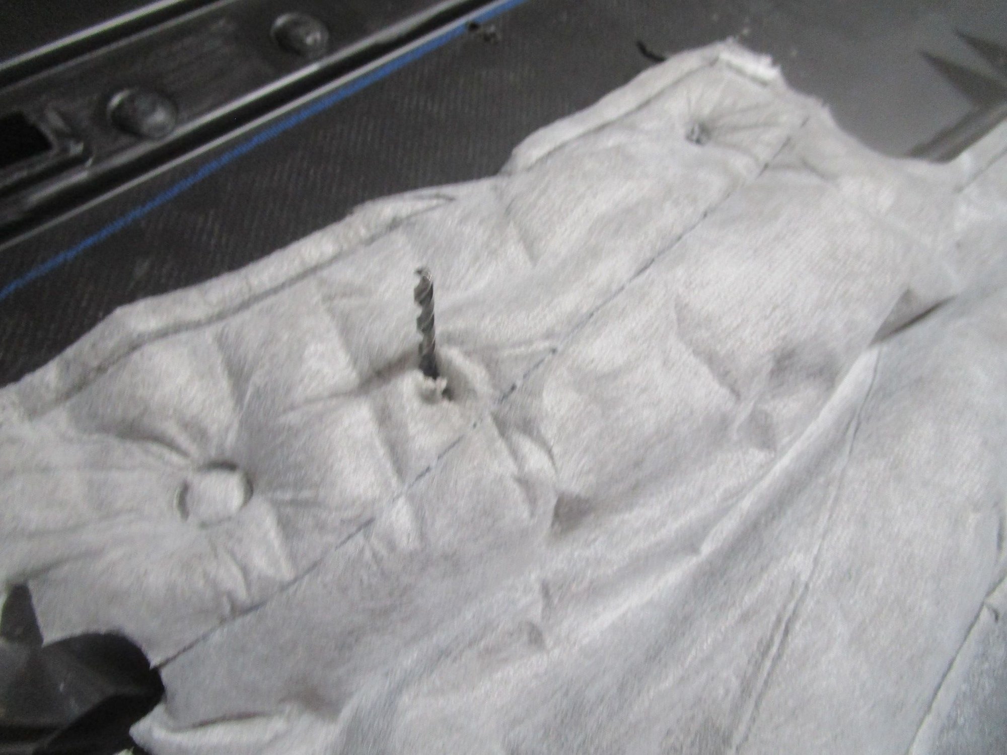

I first removed the peeling factory vinyl inserts and scraped the remaining glue and dead foam off the panel, then made cardboard templates for the foundation panels, which were cut out of 3/16”-thick plastic-coated Masonite. Prior to gluing the padding and vinyl on, the Masonite was laid over the door panel and mounting holes were drilled through both. Contrary to the video, for the driver's door I drilled the holes perpendicular to the panel's edge to make gluing the vinyl easier. I first verified where any obstacles existed on the back side of the panel, finding an insulator pad and a locating lug. Holes in pairs were made in eight locations around the perimeter of the foundation panels as they were placed over the door panel inserts, drilling through both in one pass. I used extra drill bits to keep the foundation panels positively located at each end while the remaining holes were drilled. I noted where holes were being drilled in positions which had the sound deadening pad attached to the back of the door panel, these holes were drilled only until the bit was through the panel plastic to avoid having the bit destroy the sound deadening pad. After the holes were drilled, I located the two that were inaccessible due to the pad being in the way, and slit the pad to allow the wires to eventually poke through. The holes in the Masonite were pressed flat with the butt end of a screwdriver on the coated side and the bloomed fiber trimmed with a utility knife on the uncoated side prior to pressing flat with the screwdriver. I chose to use solid core 22-gauge Bell wire to attach the panels together instead of thicker cord as in the video in attempts to avoid lumps in the finished product. The Bell wire was threaded into the holes prior to gluing ensuring the ends were roughly even for each pair of holes and then the ends bent over toward the center of the back of the panel during the gluing steps. Using 3M General Purpose #45 Spray Adhesive, three layers of the medium weight polyester batting were glued to the face of the foundation panel, the first layer the same size as the panel, layer two 1/4” smaller, and layer three 1/2” smaller than the panel. This particular adhesive was one of the products that failed to keep the factory vinyl inserts glued to the door panels, but in this application, the new vinyl is wrapped completely around the Masonite and overlapped by up to two inches and the Bell wire is clamping the glued vinyl between the Masonite and the door panel. This method has a much larger chance of remaining secured in the future.

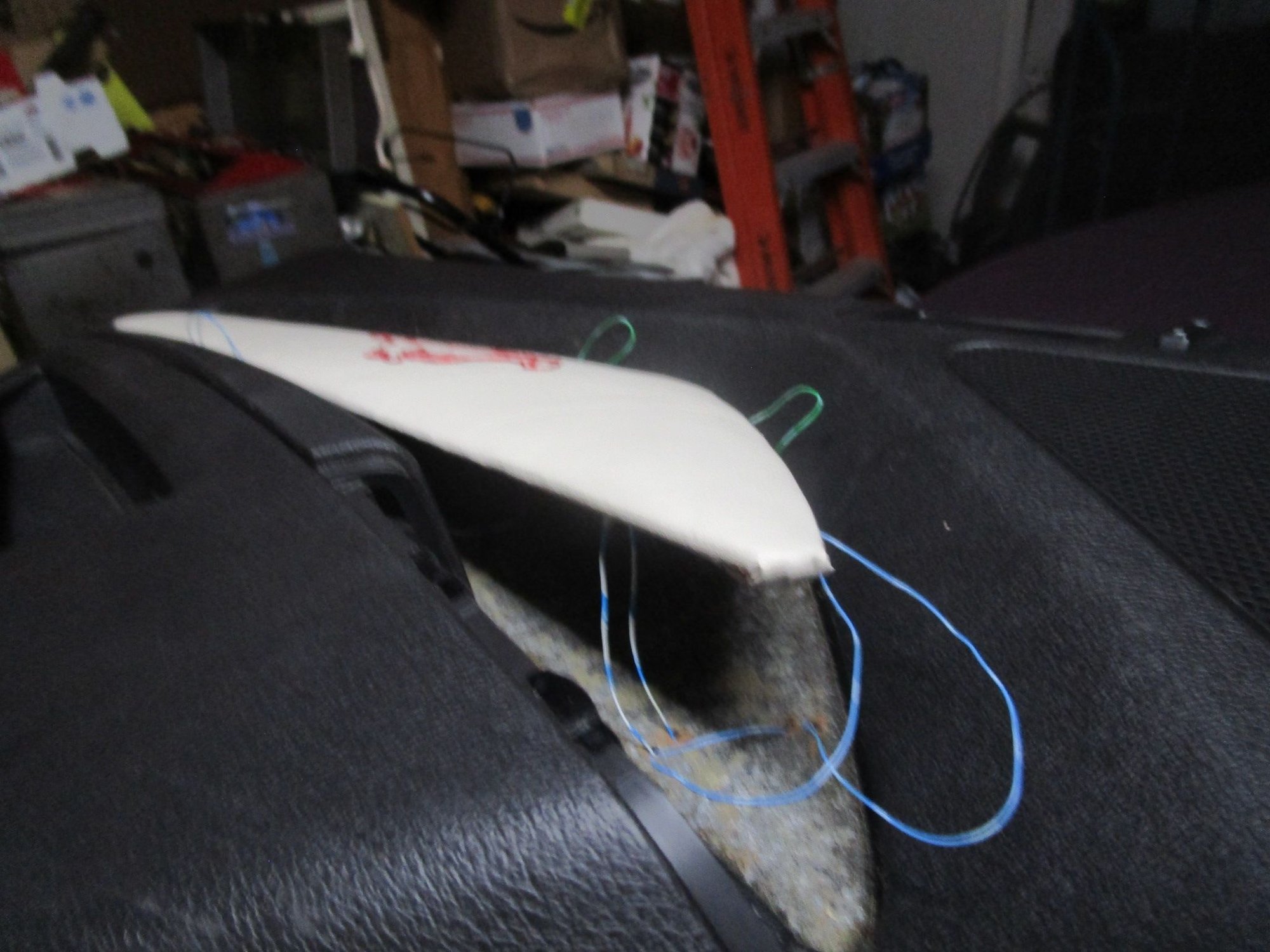

Finally, I positioned the upholstered panel over the door panel insert area, threaded the wires into each pair of holes, twisted them tightly together, then taped them onto the back of the door panel after deciding to not trim them short. The door panels were reinstalled, and so far, even with Florida weather occasionally in the 90s since November, there have been no peel-off issues.

Pay attention to the locating lugs on the back of the door panels
I used extra drill bits to register the location of the Masonite over the door panel insert area
