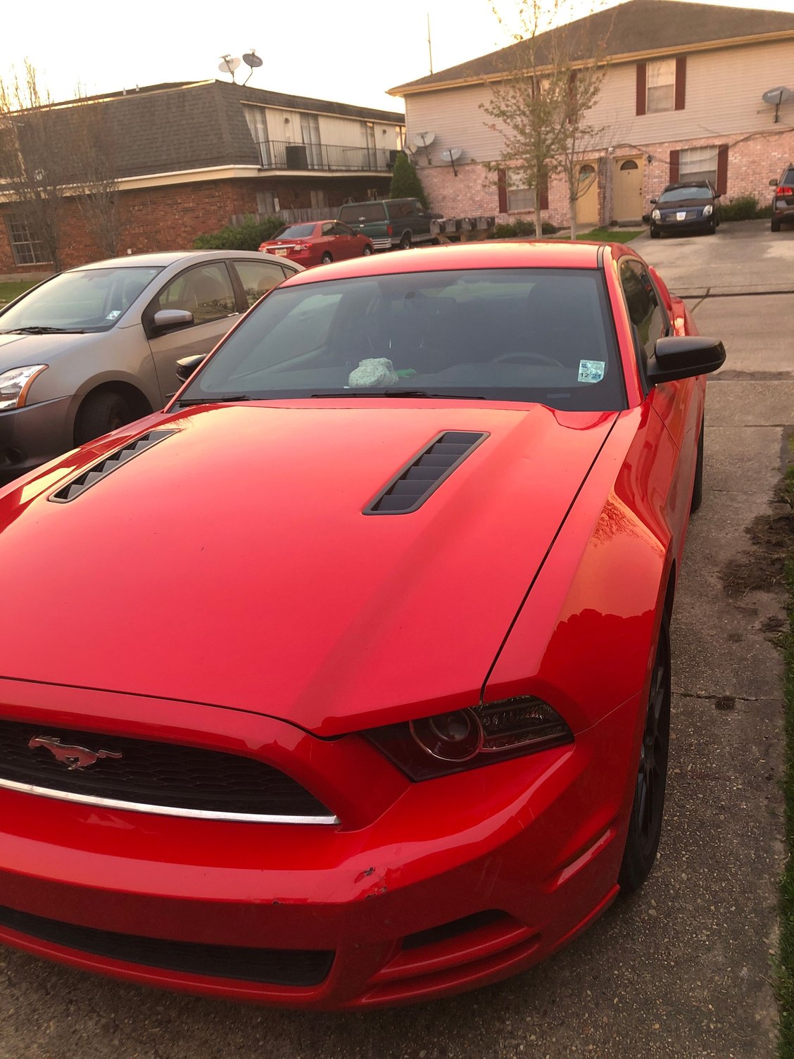

What, No Pics of the Car
Old Mar 18, 2020 | 11:14 AM
Siber Express's Avatar
Siber Express
Joined: Mar 2010
Posts: 761
From: Clinton, Tennessee
Looks good, you have 18's so from the factory the tires were good for 144mph, but the driveshaft wasn't.
