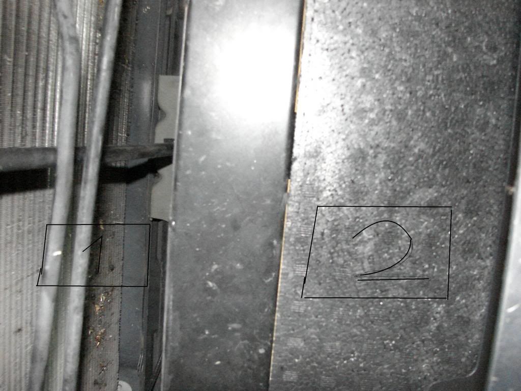

I started to mount the intercooler when I realized the power steering lines that run from the drivers side to the passenger side right in front of the rack and pinion were going to have to find a new home.
here is pic of the intercooler:
And where it goes, you can see the lines in front of the radiator that are in the way. I think its suppose to go in the area marked "1", but i'm consdering trying to take the foam out thats behind the bumper cover and mount it there. It would be closer to the front like this, which would look cooler, plus I wouldn't have to re run my power steering lines. any tips?

Honestly you have to push the a/c lines down. Just bend em its not a big deal. You could honestly just bypass the power steering cooler. Unless you are gonna use the car as an autocross or road race car the cooler really isn't that necessary.
The intercooler goes in front ofthe radiator and the piping is a bit of a B1TCH to put on. Heres apic of my car without the bumper on you can see the power steering cooler in front of the intercooler (thats a custom mounting point) and the intercooler mounting point.
Thank man... pictures really help me out alot..... And I'm thinking about bending the power sterring cooling lines at say 2 places in 45 degree angles so that it will go farther before it goes towards the passenger side, if that don't work I guess I'll use compression fittings and some brake line... But I agree with you that I don't think its really needed at all.

I guess i'm going to use a tubing bender and try to move those lines out of the way... I'm worried they are going to kink though.... I appreciate your help 2000, the heads up on the vortech manual has actually helped out alot. The setups are fairly similar.
