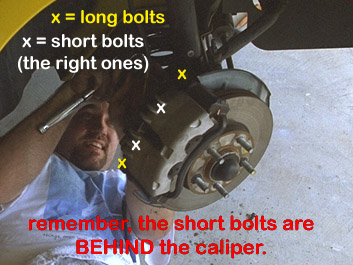

This might help:
There are 4 bolts on the backside of the brake caliper….2 long ones towards the sides (do NOT remove these), and 2 small ones directly in back of the caliper (see illustration). Those 2 small ones hold the caliper onto the rotor assembly. Unbolt those (15mm) and remove the caliper. You might need to decompress the caliper a bit by squeezing it up top. Pull it off, and you will see a tiny hole on the caliper, bend the coat hanger so it pulls through, and hang the caliper by a nut in the wheel well. You’ll see it when you look.
Source: HERE
