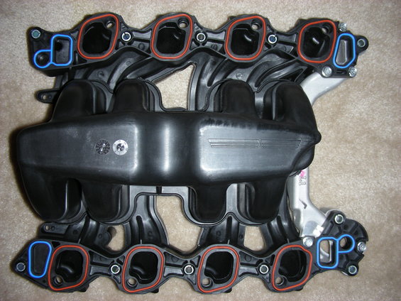

As I take apart my engine, the case against KB gets much stronger. Not only is my engine totally FUBAR'd, but it seems the blower is as well. Pictured below is spark plug #2 found on cylinder 2 on the driver's side of the engine. I completely removed all bolts that were holding down the blower, and it still will not come off after quite an effort from two able-bodied dudes. I have reason to believe that the supercharger is being held down by metal shrapnel of some sort.

I still see a bolt in the thermostat, I thought both thermostat bolts went into the head. Check again for any bolts you missed, there shouldnt be a chunk that bad to prevent removal.....
yup can see the coolant passages and bolt pattern perfect here
There is two bolts holding the thermostat in on the KB intake, they do not go into the block though. There is one hiding behind it though, but I'm pretty sure he know that.
^^ yeah exactly. I removed the one bolt on the thermostat that taps into the cylinder head.
Thanks for the support guys.. I hope this works out alright!
There is one hiding to the left of the thermo between it and the head unit. If you remember it was installed in the lower intake from KB because otherwise the head unit would have prevented it from being inserted into the intake. I have confidence you removed all the bolts but figured i would say something seeing i just did the install, and when i get frustrated i seem to overlook things sometimes.
