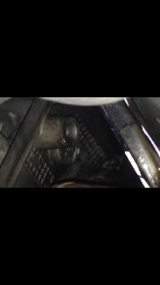

Need help my 04 mustang gt is leaking water from the engine. Maybe i need a drain plug? Any suggestions will be appreciated

Which side of the engine is that, and near which cylinder #?
The only coolant drain plug I'm aware of is on the block beneath the freeze plug at #8. That pic is of a cylinder head, and since water doesn't generally run upward I would suspect that it's peaking from the intake manifold (cracked manifold or bad gasket) and running down to wherever you snapped that pic from.

I took the picture from underneath the car. the heads are stamped with no. RF-1L2E-6090-D22D.

its from the passenger side.

this is from the driver side and it shows what I believe I need to stop the leak. any ideas

The pic isn't helping.
First, you need to rule out a bad intake manifold.Look for antifreeze in the block valley,and look for a leak from the rear heater hose connection to it..The manifold is by far the most common leak source.
