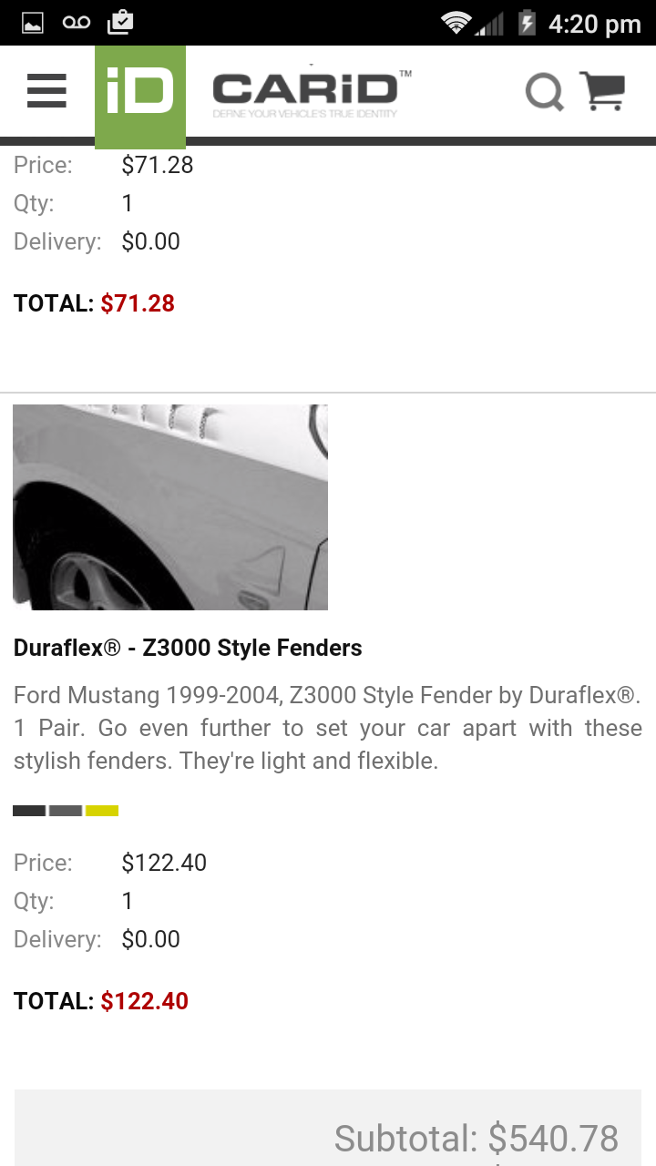

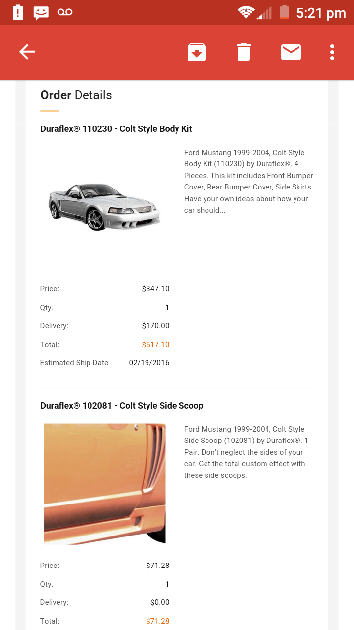

I ordered an aftermarket body kit, side scoops, and New fenders for the 2002 GT. The front bumper with the cobra lip on the 2002 will go to the 99 and so will the passenger side fender, side scoops, and headlights. I will also be removing the HID kit from the mark 8 and installing it in my 2002 GT Coupe. I will update this thread as I go along and progress. I will start showing off how to install both a 2 valve and 4 valve engine in these cars step by step. Feel free to chime in with any advice you may have for me I welcome all comments.
