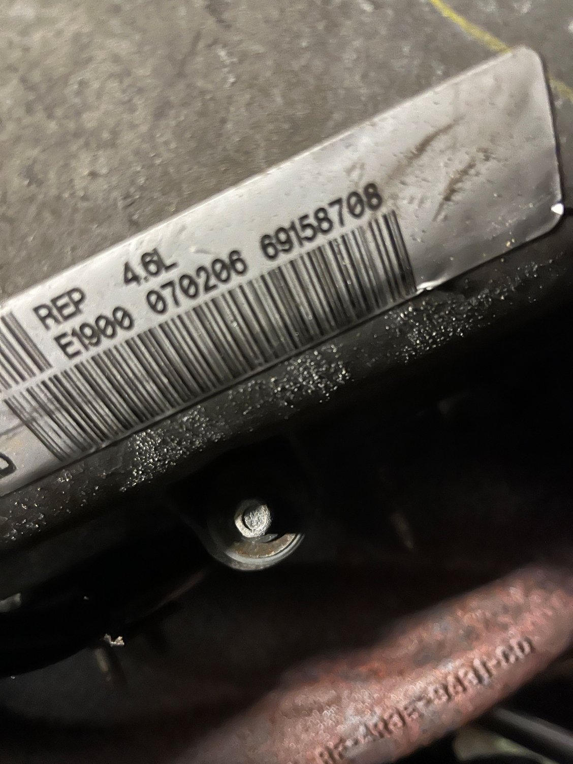

I have a 2006 Mustang GT track car and I’m getting a P0198 P0298 oil temperature too high DTC and lowered rev limit that goes along with it. I know my motor was replaced with one from another Mustang GT. It is dated 070206. While inspecting the oil temp sensor, I noticed it was “modified” to accept the electrical connector on the wiring harness. When I got a new oil temp sensor from Ford, it’s a totally different style. The one that was hacked up is all plastic while the one the dealership gave me is brass. The funny thing is that the electrical connector fits the brass sensor. Did Ford change the style of this sensor at some point? I wish I could just screw the brass sensor into the pan but it is a smaller thread. That’s how I stumbled across this thread. Will the 1/2 to 3/8 reducer allow me to fit the brass sensor into my pan?
