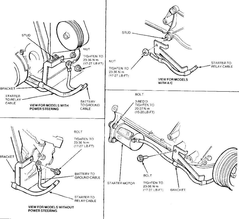

any body know how the neg cable from the battery mounts to the engine.under crank and to what bolt.I dont remember how it went.I have to much slop.

seems like it bolts to studs that are in the bottom front of the timing cover on both sides of the timing cover

This might help?

You've always got the best diagrams.A+ post again.

Yeah those are great, where the hell did you find them?

Cool thank you, much help
