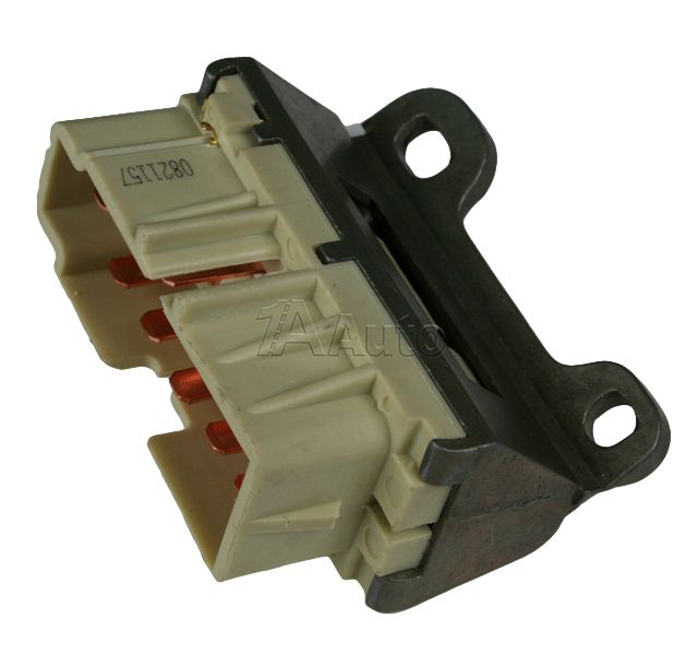

I changed the starter switch pictured below. It's bolted to the steering column with break off bolts... I have not triedstarting in nuetral or wiggling the shifter while cranking. Next time itoccures I will try both.
