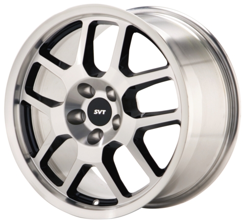

Can someone explain to me the compatibility of '05 + year Mustang wheels on a '94???? I understand there is an "offset" difference? Is there a fix? Do they cause rubbing on a '94??
I have a '94 with the 17" tri-spoke wheels; looking for something off a Mustang, 17", but 5 spokes.

The '05/'10 Mustang's generally have +45mm of offset, while wheels that come on Sn-95 Mustangs like yours have between +24/+26mm's of offset. So if you swapped a set of these onto your car, it would result in the wheels sitting to far inward and maybe some inner fender well rubbing. This could be fixed with a 20mm wheel spacer.

2003 Cobra Wheels 17" by 9"- Specs
2004 Cobra 10th Annv. Wheels 17" by 9"- Specs
2000 Cobra R's 18" by 9.5" - Specs
FR500's 18" by 9" - Specs
2007/08 GT500 Wheel 18" by 9.5" 45mm offset - Specs
2005/09 Mustang GT Wheels 18" by 8.5" 50mm offset - Specs

yeah, in order for 05 wheels to fit your car correctly you'd have to run a huge spacer, you're better off buying wheels made for your year.

We have several wheels in the appropriate 05+ offset for your vehicle. However, you can get away with running 9's all the way in the 94-04 offset, just can't go staggered.
