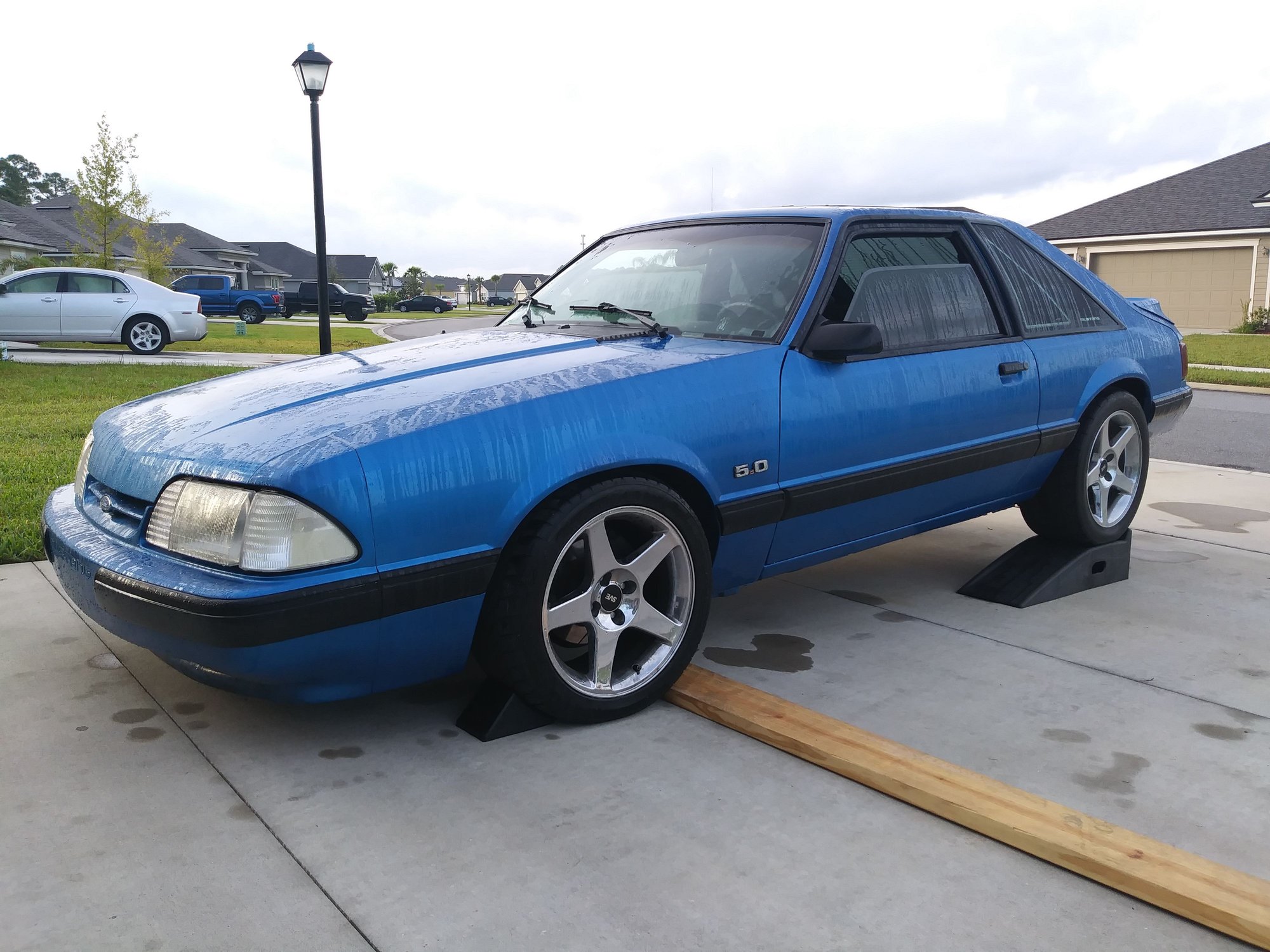

Hey I just bought my second LX 5.0 this time a 1990. I had a 1989 12 years ago. This car is very modded and I am having a over heating problem. I think my set up might be to much for a OEM radiator which it has. Here is a list of my mods.

The previous owner said the supercharger has only been on the car for about 200 miles. After about 20 minutes the car over heats. I replaced the radiator cap. I only saw some water that had leaked around the edge of the hood and battery area. Each time it over heats I need to put about half a gallon into the radiator. After a 10 minute ride today I put it on ramps and saw no leaks under the car around the water pump and hoses. Also the car didn't leak out any fluid and the overflow tank was at normal level. When the car does over heat the overflow tank is about 3 inches from the top and somewhere under load coolant leaks out. The OEM radiator I have is in good condition. Can a OEM radiator handle my set up? I just got it on the road this week...
