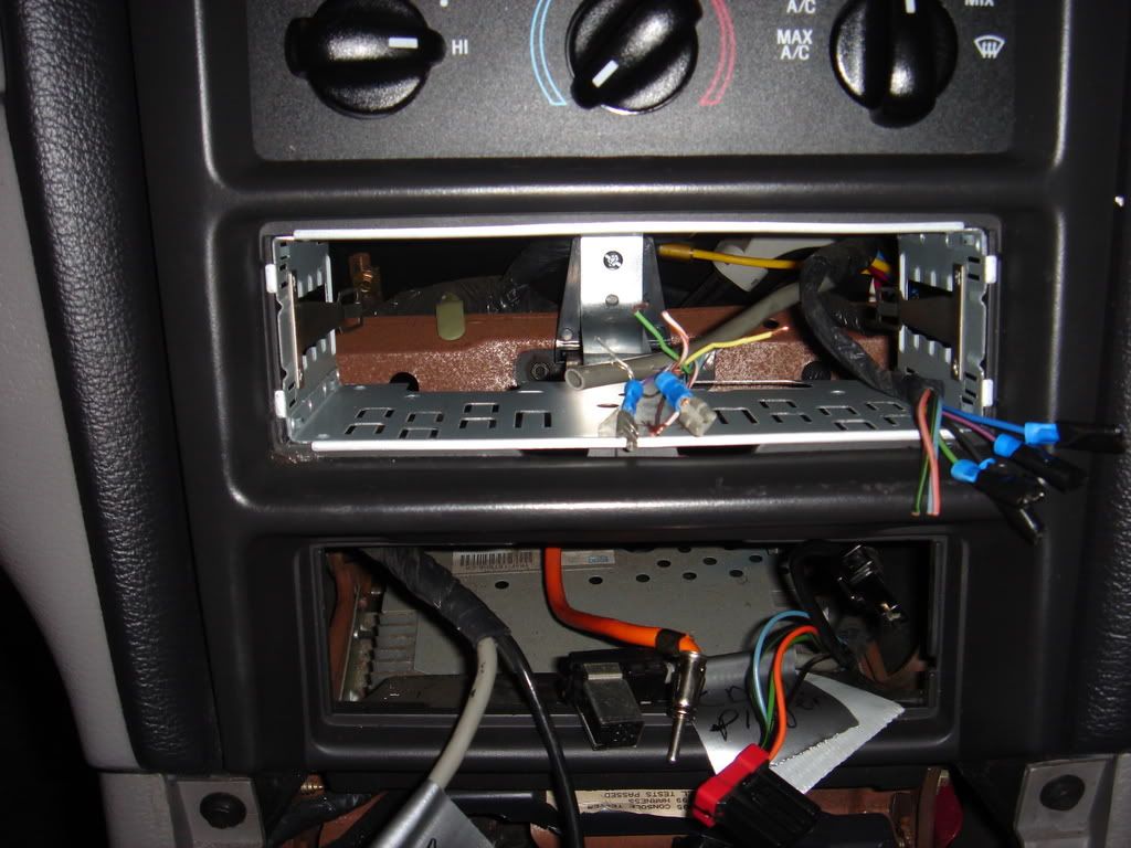

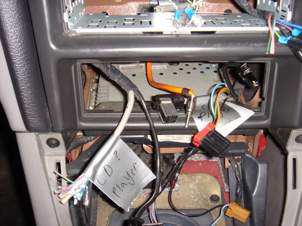

Pictures of the wires. Orange is antenna that goes into the radio, cable marked cd player is either a 6 or 8 pin cable that runs between the CD player and radio. Red plug is power for the cd player, two black cables are radio and cd player housing grounds.
Top wire bundle are the speaker wires and power harness.

the hrns that is cut is the factory amp input. It will be a pia to figure out the wiring on it unless you know what you are doing. I have been doing this for over 10 yrs and I would not look forward to it. You would be better off replacing it with an aftermarket unit and bypassing the factory amps. You will need to replace the speakers as well if you want any kind of bass responce since the amp drived the woofers and all you will be able to power is the tweeters. Who ever cut that hrns really did a good job.

which harness are you talking about? Second picture, top DIM, left most cut harness is speakers, right most is power. And its not that big of a deal to wire in and get rid of the speaker pop. Helms has great wiring diagrams. I do agree with TTocs that if you do not know what you are doing, bypass the amps, otherwise, use a four pot dial in and some resistors and you are good to go
