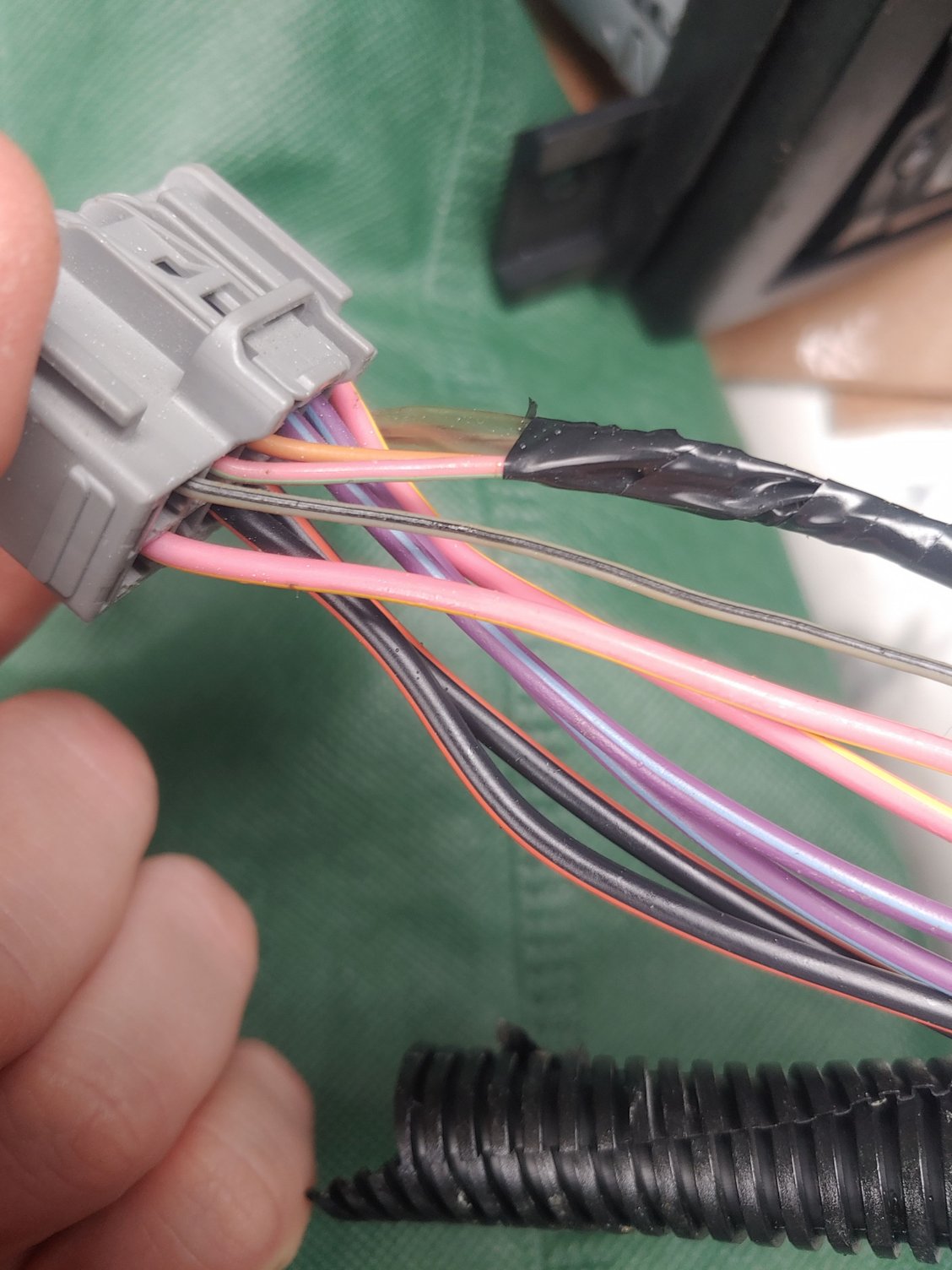

I'm trying to figure out the wire colors involved to t-tap. I'm trying to put an after market amp and sub in the trunk and theres already shaker 1000 wiring run for the trunk subs. I can't find how to identify the wires for "+, -, remote, ground, power". There are 10 wires to the trunk plug. I think maybe they would be the same colors as the door amp wires? What are the colors of the wires to the amp in the door and what are those colors corresponding function
