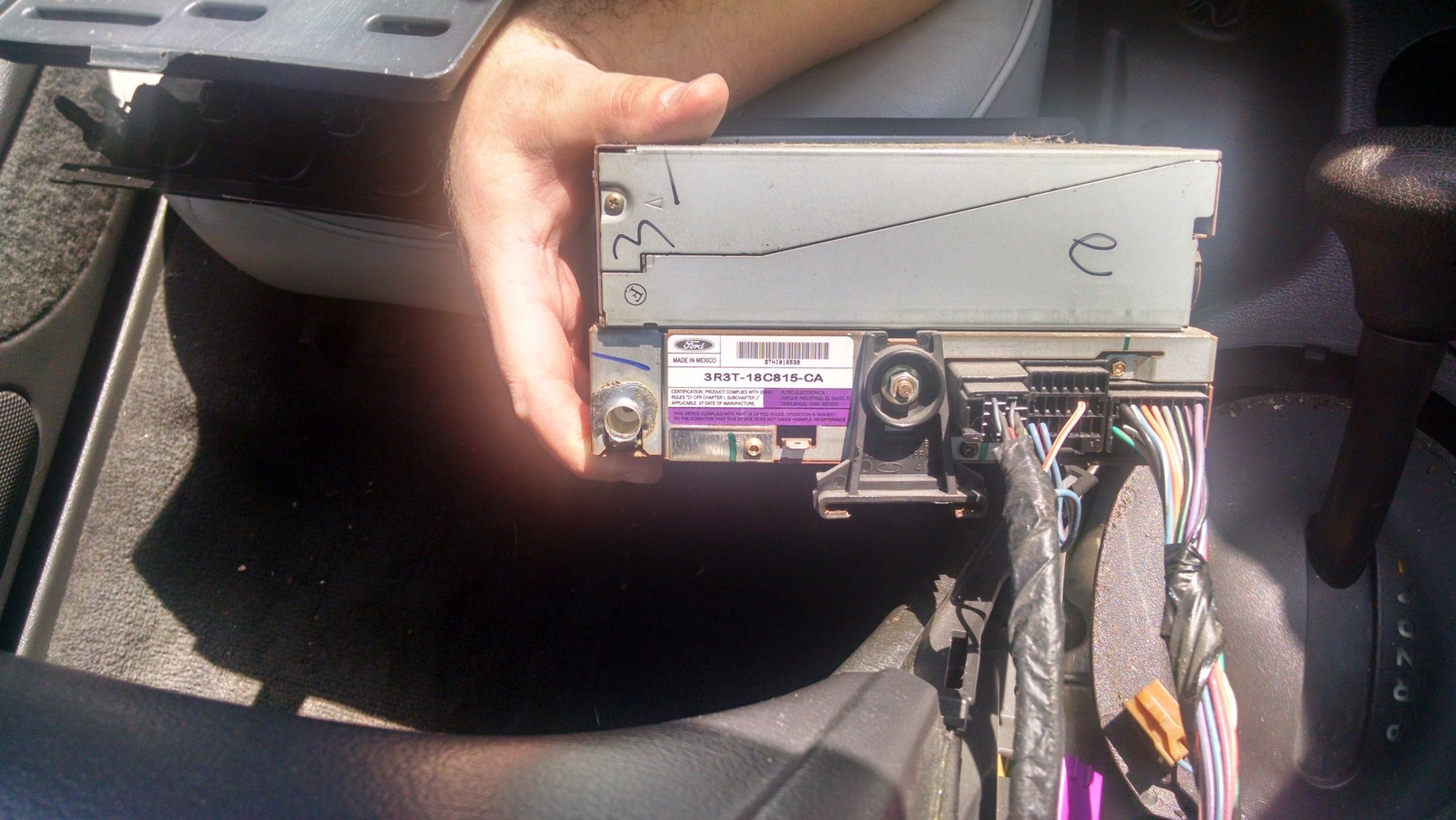

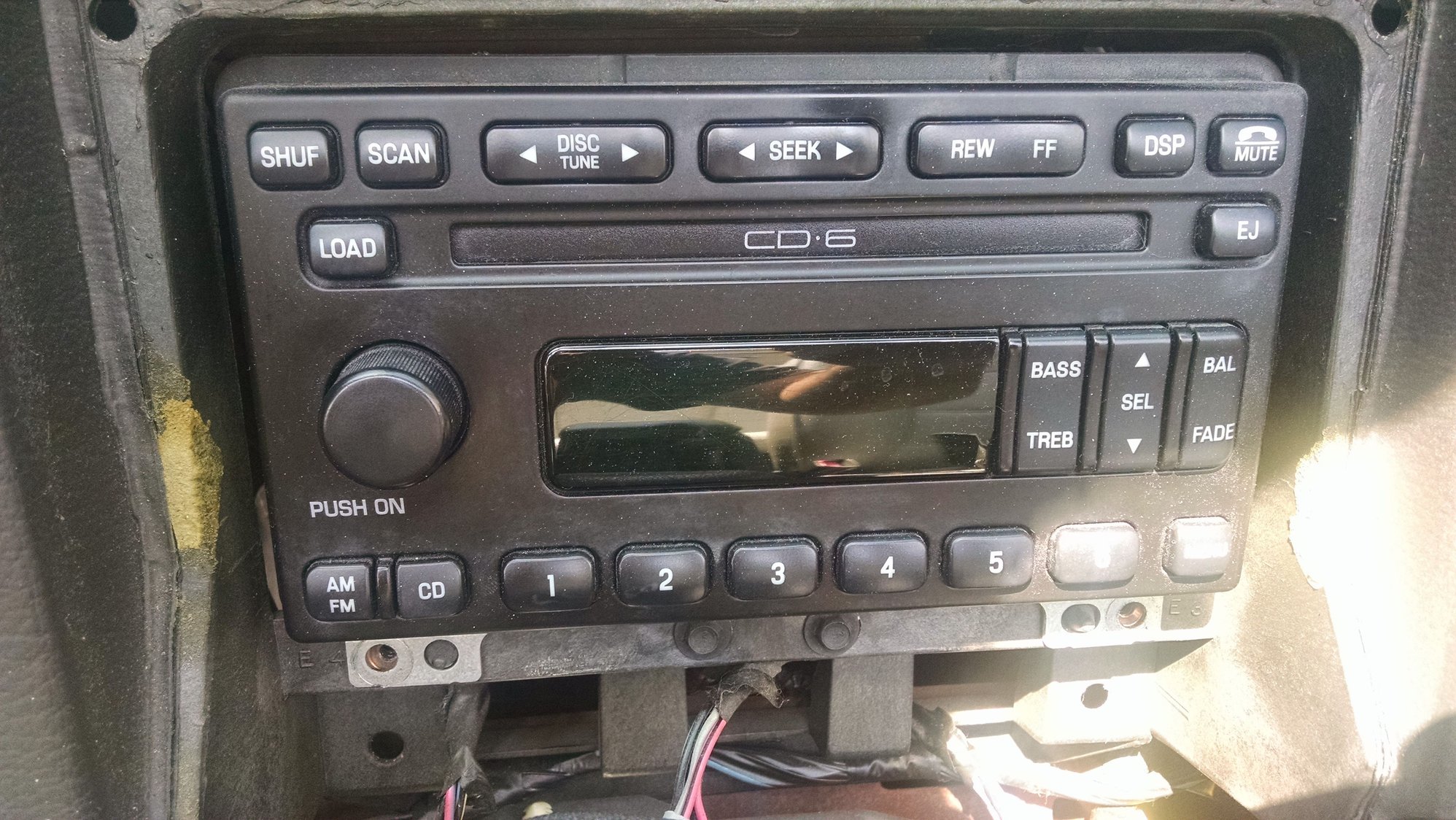

Here are the pics of my radio. Hopefully this will help answering my question.

your car is not wired for an external audio input. Pins 16, 17, 18, 19, and 20 of the middle connector are unpopulated so there's no external changer support. I don't think those adapters will work for you.
