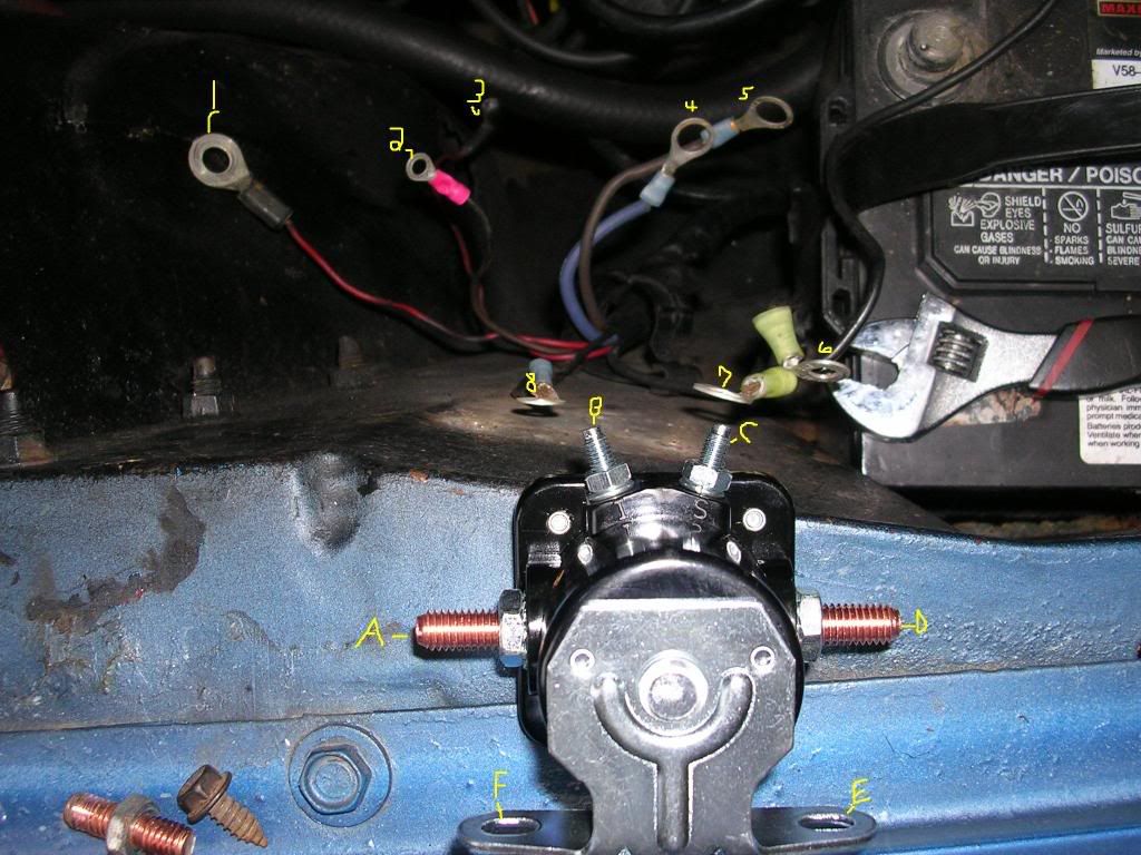

Yes sir that worked. Now im trying to figure what wire goes where on the solenoid...ill take a pic in a sec.

Ok its a sorry picture but can anyone help me match the numbers to te letters?
http://i26.photobucket.com/albums/c1...ireDiagram.jpg

PRetty much the only wires im not sure of are the ones that go to D and A....i got everything else... i think 6&7 go on D....but im not sure on5,4

Nm, took a shot at it and got it. Rusty Nail is running great. Was the Ignition switch.
