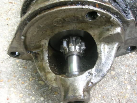

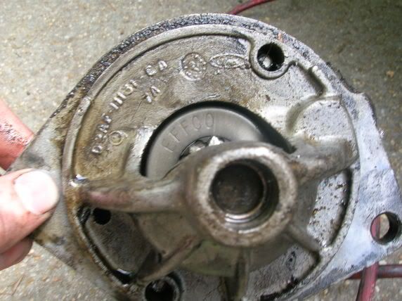

Here's a pic of the starter pulled...the teeth look a little boogered up dont they?
http://i26.photobucket.com/albums/c1...ST/Starter.jpg
http://i26.photobucket.com/albums/c1...T/Starter2.jpg

Yup! That starter is toast.

im just scared to start it with the new one in...what if the starter wasnt the problem and it tears this one up too? [:@] oh and btw i looked up the engine code and its a 68 302...
