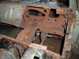

Unchecked, the cowls might turn out like these[:'(]
[IMG][/IMG]
[IMG][/IMG]
[IMG][/IMG]
[IMG][/IMG]
[IMG][/IMG]

That must have been fun to repair, hope mines not like that.

Cusbuild,
You seem to be preceding me in all of the jobs I am about to undertake. I am about to do the same fix to my 68. How did you seal the inside seam on the cowl box after you welded it together? I am worried that this seam will rust because it is exposed to the elements and is not accusable for sealing after the cowl box has been welded back together.

ORIGINAL: 68FastbackGT
Cusbuild,
Haven't replaced the cowl yet want to get it painted inside prior to welding it back together. You have me thinking though, because I hadn't thought about that. My first thought is that once it primered with weldable primer and of course the interior of the cowl is fully primered and painted, I would "think" that the flanges once welded would be safe from rusting once all of the sealer is applied to the outside. My reasoning behind this would be that the seam didn't rust the cowl/ highhats rusted away. I had to still drill out ALL of the spot welds and seperate the two halves, but the damage was from the crap inside the cowl and from the orginal Ford engineering/assembly process that welded it together prior to primer. If in 65' Ford would have had a dip process for applying primer Mustang owners would be a much happier group in general. Beyond that I don't really know any type of sealer that could be applied between the two flanges I would think would be destroyed in the welding process or would catch fire which isn't good either. Don't really know and now I will be thinking about it for a while. I know a couple of resto shops here in Indy I may have to give one of them a call and see if they will tell me what they do.
