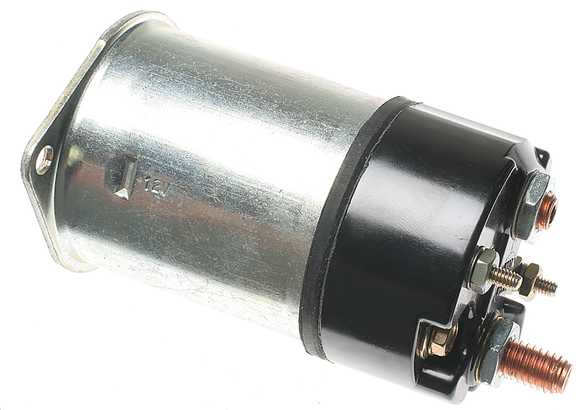

Ok, 1 more question on this starter solenoid. I have a 74 351W in my 67. I'll probably pick one up locally, butwhat style should I get? Here are two different ones I found on the net, the first being "1967 - 1971 Ford Mustang" and the second "68-77 Ford Mustang Mercury Cougar"
http://performance-auto-group.com/im...e/PICT0001.jpg
http://images.channeladvisor.com/Sel.../15/SS-212.jpg
Old Jun 29, 2008 | 10:37 PM
Starfury's Avatar
Starfury
Posts: 5,896
From: Elk Grove, CA
Default RE: Battery relocation...
The second one is a starter-mounted solenoid, not an "electromechanical starter switch," which is the actual name of the part everybody calls a "starter solenoid." You need the first one.
