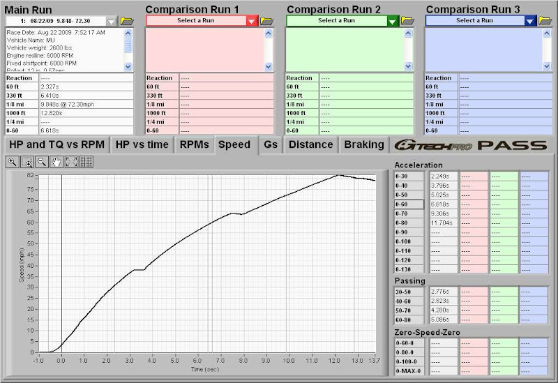

the engine is wellbehaved, but there's something I'm doing wrong.
The G-Tech tells me 9.5s 1/8 miles and every racing calculator under the sun certifies that with 150HP. edelbrock advertises the combo with 350fwhp and I'd be glad to get 250rwhp out of it. It is strong, but it defiently does not feel like a 250HP car.
I think the biggest problem is the ignition curve. i tried 12 initial with 34 max, then i tried retarding 2 degrees which seems to make it slightly worse.and i believe i hear something like a slight dinging going up a hill with light throttle. i think I'll disconnect the vacuum advance completely and then try a few different settings, springs
Any opinions on that g-tech output below ?i think the 150HP seems quite right :-(

then, according to http://www.theautochannel.com/vehicl...f65mcont.frame the K-code was putting down those numbers:
Axle Ratio 4.11:1
0-30 mph 3.0s
0-60 mph 7.5s
Standing 1/4 mi 15.7 @ 89 mph
Top speed 117 mph
Source: Sports Car Graphic 9/64
i only have 3.5:1, but trac loc, which should help plenty getrting off the line
So it seems I beat that, how far am I really off ???
how much more is there in my engine? plenty or am i really at 300HP already ???

I wouldn't trust a g-tech as far as I could throw it. Go to a real track and find out for sure, I'm sure you'll find the g-tech is probably way off.

67m302: the biggest problem is that there's no track in this country. i never heard of anyone dragracing. if i find out, I'll probably travel there to go down the strip. So the G-tech is all I have. I found the HP readings of it ridiculous, but somehow that thing is repeatable. So i can see improvements, even though I don't know how correct they are. it feels right though when i check on speed and gears in that chart. i once managed a 5.8s 0-60 and 1/8 mile of 9.5 seconds or so. and it felt quicker. stupid me never wrote down what I had as settings (ignition, jets .. etc)
I can't seem to find reliable info what the car actually should do in 1/8 mile. as said the K-code 271HP did standing 1/4 mi 15.7 @ 89 mph, which I should beat hands down. but racing calculators comment on this with 150HP ?!
So how much is actually really in there.

Hmm, it might almost be more accurate to mark off an 1/8 mile and run it and check your mph on the speedo.
