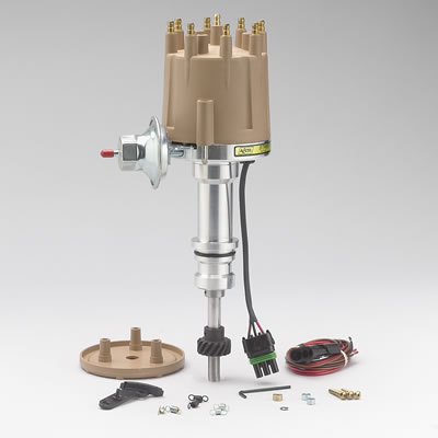

I went with another choice that hasn't been mentioned yet. I put an Accel Street Billet Distributor and an Accel coil. It keeps roughly the stock look, and I've been very happy with the performance. The distributor is a mag pickup electronic ignition distributor (no extra ignition box needed) with an adjustable vacuum advance and the coil is an OEM style coil similar to the Pertronix Flamethrower. Here's the link to the distributor http://www.summitracing.com/parts/ACC-52201/
Here's what it looks like installed:

I used an inside distributor Points Eliminator kit from Accel a few years ago. Being mine is a 45 year-old car that is driven (almost) daily and long road trips in the summer, I got ticked off when I had trouble finding a spare (proprietary) rotor. (yeah, I'm funny like that!) I called Mr. Gasket/Accel tech support, and they were less than helpful. I yanked it and replaced it with Pertronix Ignitor, which allows me to use any rotor I want. I dont use any Mr.Gasket/Accel products.
I'm sure yours is a better thought out product. Just make sure you can get replacement parts wherever you may cruise.

I've already replaced the rotor once. Got it from my local Advance Auto parts with no problems.
