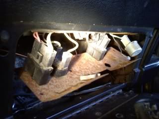

Old May 8, 2010 | 10:14 AM
Mach1BBFun's Avatar
Mach1BBFun
Joined: Apr 2010
Posts: 75
From: Georgia
Found it!
Thinks for the wiring diagram, knowing the colors i was looking for really helped.. i would have never found it without that..
It was tucked up on this glove box panel which im guessing is for ground because it is solid metal
