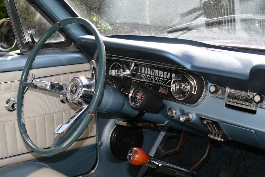

Here is what I really like...
(Pic stolen from a current ebay listing, sorry)
Here is the question, the exterior on the car is Caspian Blue, but the door and dash on the car pictured look like a different lighter shade? Is it just me? Did they paint the inside of the door a different color than the outside? If so then where did they transition on the door, at the rubber seal?
Can anyone tell me exactly what door panel color combo that is?
Here is the dash, I like the color but is it Caspian blue or a second paint color?
That's aqua and white. BTW, the two-tone panel you show is aftermarket, no such panel was ever produced by Ford. TMI makes them.
There was an aqua and white deluxe interior, an excellent choice with that exterior color, although very rare.

Any hint on if the dash and door metal is Caspian? It looks lighter to me?
Hiya,
kinda funny. my car was original caspian, not it's midnight metallic blue. which is not too far off the caspian. the caspian is a dark blue and the interior is aqua/white like 2+2 says. there interior colors are much brighter than the exterior. there is no reason to have the same inside/outside. I absolutely love mine the way it is. Outside is in signature and inside is like in your picture, just with different door panels. It's a fantastic combination I think
since I took this picture I replaced the steering wheel (like for like), put in an aftermarket vintage style radio (to fix the horrible cut around radio), added rubber to the pedals with trim and the parking brake handle is about to go in *g* and i'm still looking for the trim between dashpad and window ...

The aqua interior paint (and dark aqua on the dash pad and carpet) was a different color than the exterior.
Cool, thanks guys. So if I paint the dash and other metal & fiberglass/plastic aqua I should end up at my target goal for the interior?

two options. do whatever you like or stick to what it should be (restore) and make your mind up before you start with anything.
if I am not misunderstood, I'm sure that 2+2 can clarify. there is only one single paint that you use inside for spraying and that goes on all metal parts inside. all other parts with different coloring come painted already (door panels, seat covers, dashpad, carpet)
So to sum it up, The door panels are TMI and available.
The interior metal parts (and possible the restored fiberglass panels) would be painted /dyed with "Agua" and that is a lighter color than the exterior "Caspian Blue".
So, where is the best place to transition from Caspian blue to the aqua on the door? I would guess that you use a mask right where the weather strip will go?
