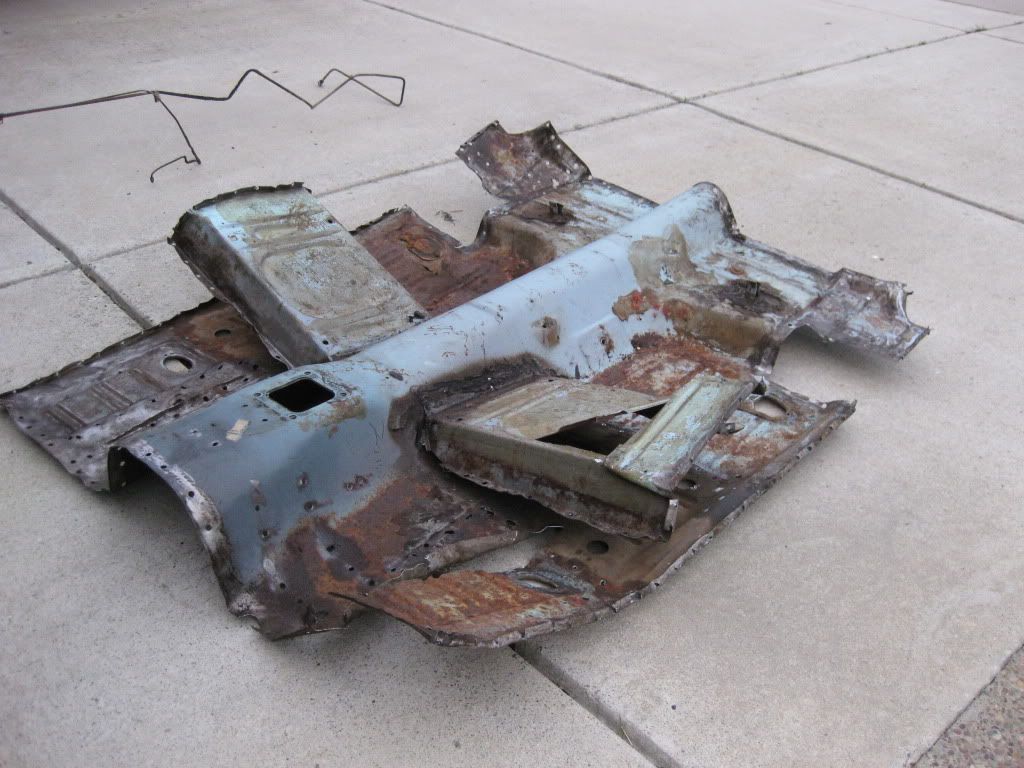

You're right, the torque box was only on the driver side and not in the passenger side. Kinda weird that they would install it on one side only.
Here's a picture of my old floor pan drilled out and on my driveway.

Wow, nice work. That's like having a scab come off in one piece and new skin underneath.

It came off real nice. Looks like your floors were not too bad.
