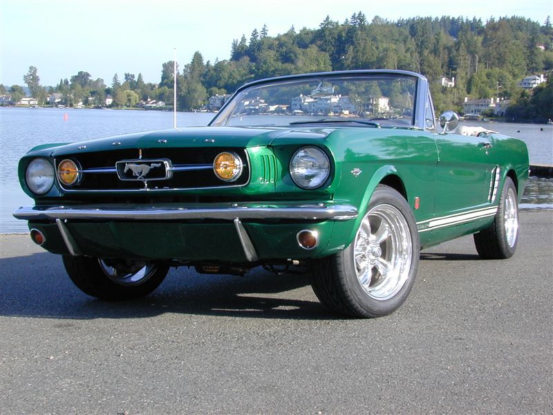

I need to stick with the easy stuff like building a the car. The more I look at tires and wheel on cars the more undecided I become. People must think I'm crazy, every time I walk through a parking lot I'm looking at tire sizes.
Norm, thanks for the explanation, I'll be going with 8" rims. When I read what people have done many still run 7s in the front. Considering that the front is carrying all the weight it doesn't make sense to me.
Still don't think I want 17s on a daily driver in the land of pot holes. There more I look at this picture the more I think the 225/50R16 is the right fit.

I run 225 50 16 on mine for the front its perfect. I have also seen alot of them the run the same in the back i went with 245 50 16 which is to wide they hit the quarters, will be fine once get my new rear. Ive read alot of people run 225 all around with no problems tho with mid eye leafs.
