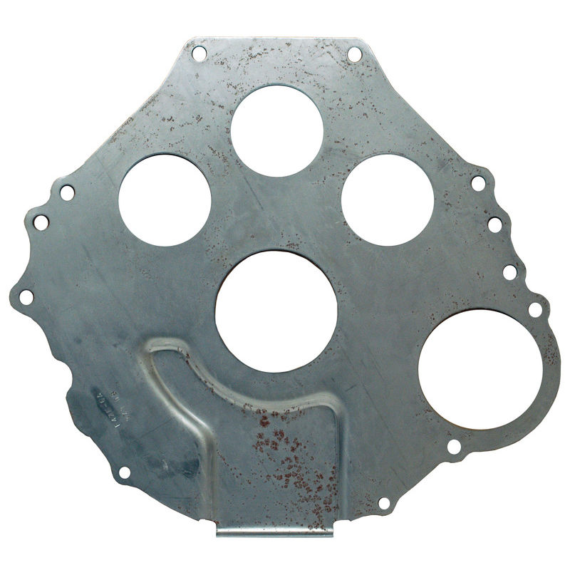

I sold the adapter, I meant this

Oh, that's a "rear engine cover", and you definitely need it.
