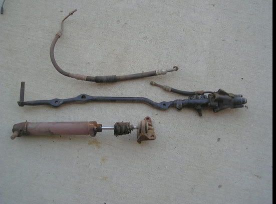

I have a 66 mustang im thinking of doing a power steering conversion on.
im unemployed so have very little money, so it need's to be on the cheep.
I have a pump and a guy is selling this for $10 bucks
will my tie rod end's work with it? cus i just replaced everything under the car so would love to use em.
I know that the 6cyl car tie rod ends are different but not sure on the v8 (mine is a true v8)
i found this on line but there car is a 6cyl not a v8 so im not sure if mine will work or not sense it's already a v8.
http://www.mustangmonthly.com/projec.../photo_10.html
any help is very appreciated!

Pity. That's a later model centerlink/valve assembly, won't work on your 66.

The PS pictured is indeed later model (To be exact, a 67 unit), and will not work with 65 66 V8 Tie Rods. Totally Different pieces from 66 to 67.
No on the Ranchero. Different well.
Only PS that fits the 65 66 V8, is 65 66 V8, Not even the 65 66 6 Cylinder will work on the V8 Car.
