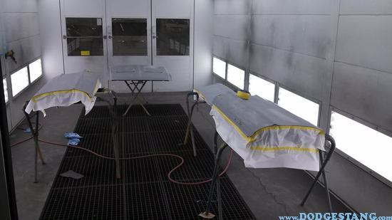

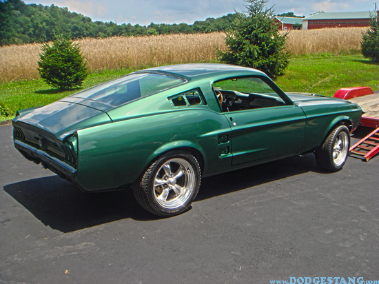

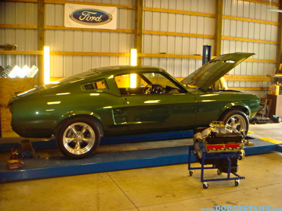

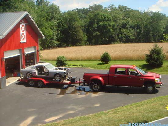

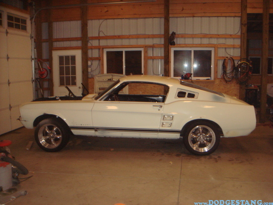

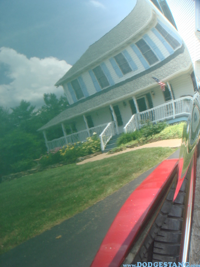

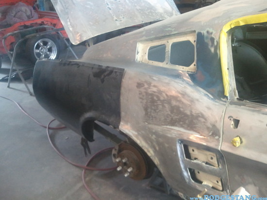

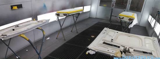

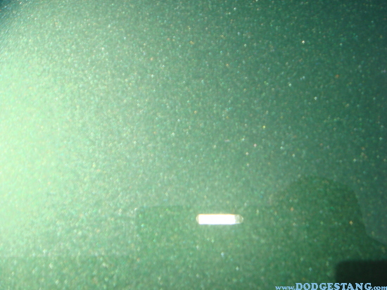

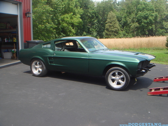

I wish more shops understood that. It took me a while stuck between 10-20k paint job estimates and Maaca specials with nothing in the middle. Then I found someone, went to Wyotech for painting, just starting out, into mustangs, and looking to do more that just bumper resprays at insurance shops.
$1500 for materials
$2000 for labor
We found some metal that needed to replaced and subbed it out since he doesn't weld so I had $1600 in unplanned expense
I took it 'mostly' apart myself and he took the front and rear valances off for a better job since it was a color change. We pulled the doors together and then away it went.
He did all the prep work basically in my garage and then we towed it to where he works that allows side jobs on the weekends. Dropped it off 10am Saturday morning (yesterday) and picked it up 10am today (Sunday...the next day). He pulled a 24 hour/all nighter on it and it looks awesome.
Lesson here...perseverance for the OP, you will find a decent enough place.
Before
Prep
Paint
Back home and ready for me to put it back together
