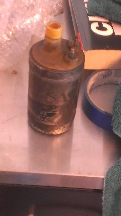

Looks like this guy is about 50 years old... Replaced the coil and ignition with Pertronics. She starts up faster now I can say that for sure.

lol...yeah but it looks WAY better than your door latch laying on the ground and guess what . . that area can not be welded/repaired very easily.
that coil is probably worth $10.00 on ehay but i would keep it for a spare . . the std msd coils burn out occasionally . . the santi vibration ones don't just in case you bought either of these
