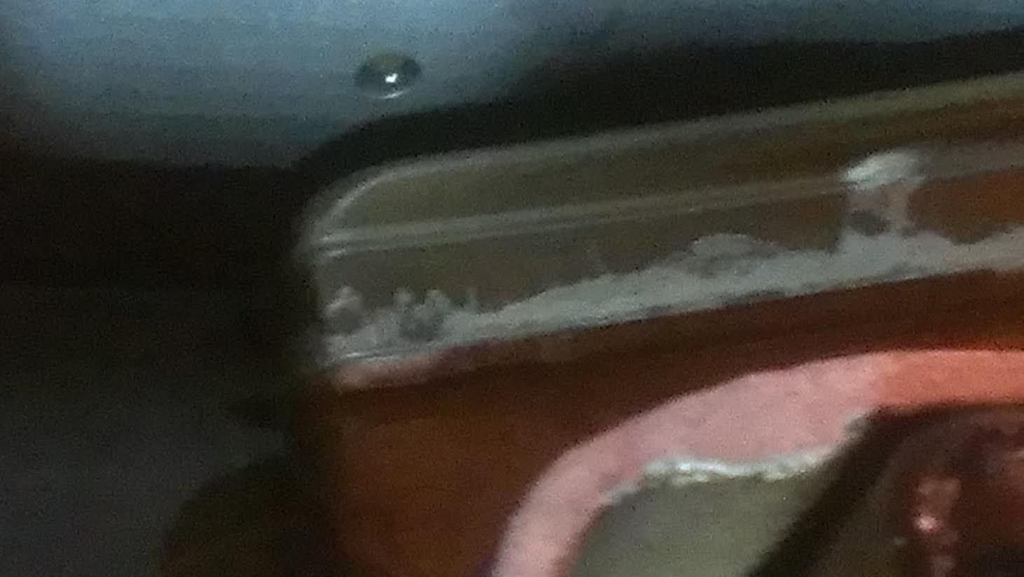

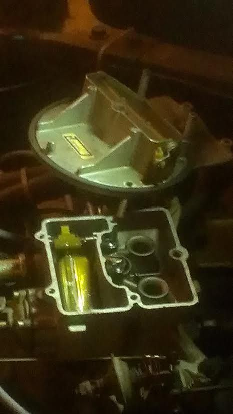

Posts: 113
It looks like it is an Autolite 2100 refurb.
I couldn't find the normal model number stamp on it, this was the only stamp I found.
BTW, is that spring being totally mashed an issue?
Old Feb 22, 2015 | 05:04 PM
  #56
barnett468's Avatar
barnett468
Joined: Nov 2013
Posts: 1,398
From: arizona
that carb is much bigger than stock and it is not for your car but it still should work . . get us the main jet sizes . . they are below the float.
remove thsat entire cam . . you can try to fix the spring later or buy a new one.

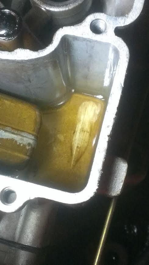

Posts: 113
Looks like there is a lot of dirt in the bowl. The gas itself is clear on the other side of the bowl. This side just has tons of sediment.
Here is a pic of the jet below the float.

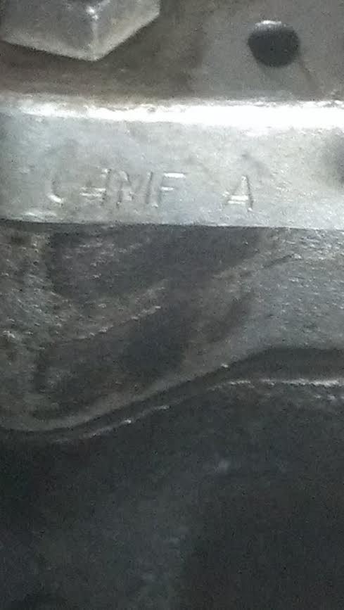

Posts: 113
C4MF-A for a Mercury Monterey???

  #59
barnett468's Avatar
barnett468
Joined: Nov 2013
Posts: 1,398
From: arizona
size.................424 cfm
fits..................64 mercury
eng size...........390
289 must uses...300 cfm
