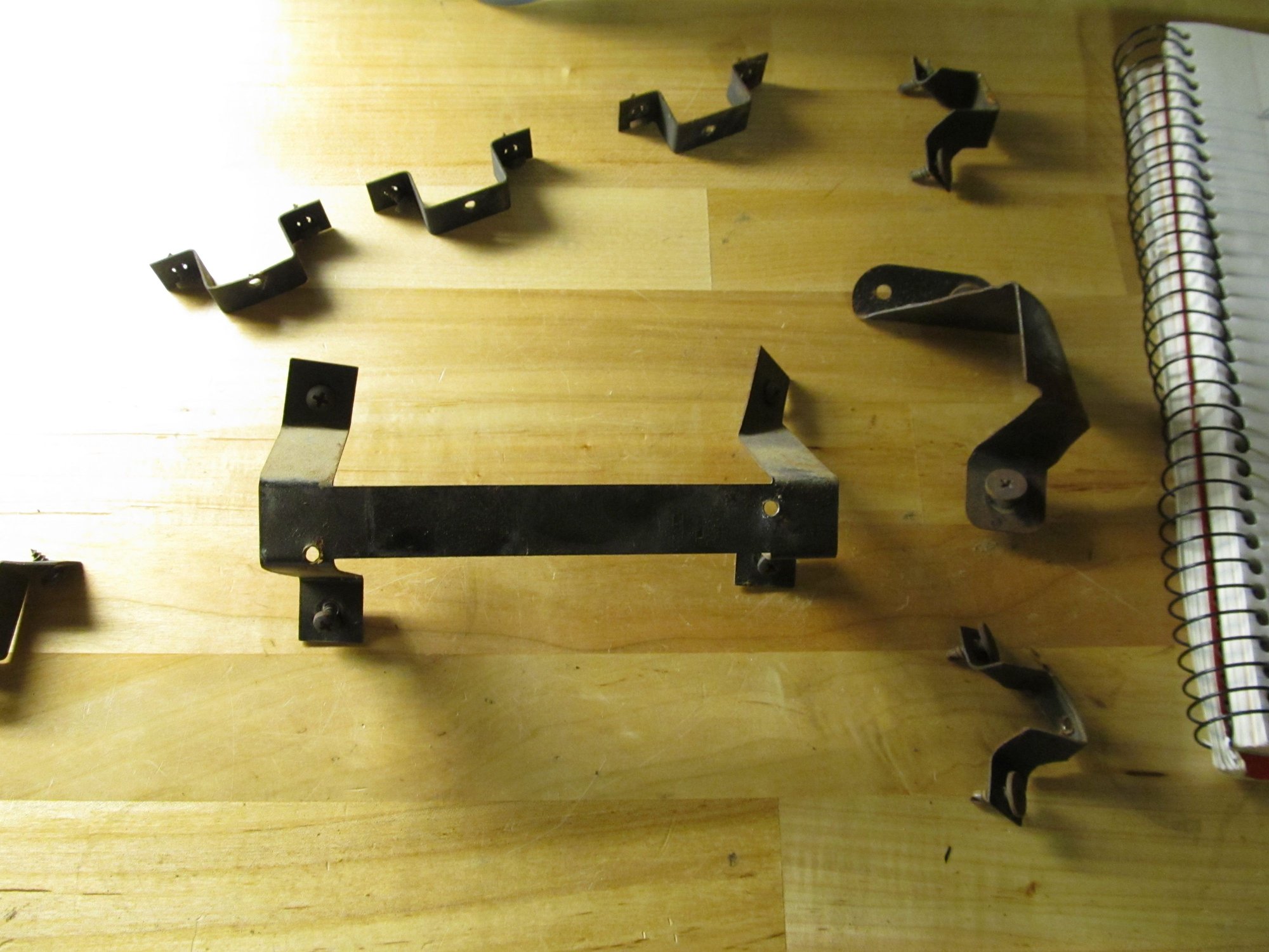

hi,
i need to know where every pieces of the dynacorn 37 pieces interior bracket go ! did anyone can help with this ! i know a couple of them but not at all !
i attache a picture with the post, hope that work !
thanks
Mathieu
Attached Thumbnails 1968 mustang fastback interior bracket !!-67fbbrkt_1_448.jpg

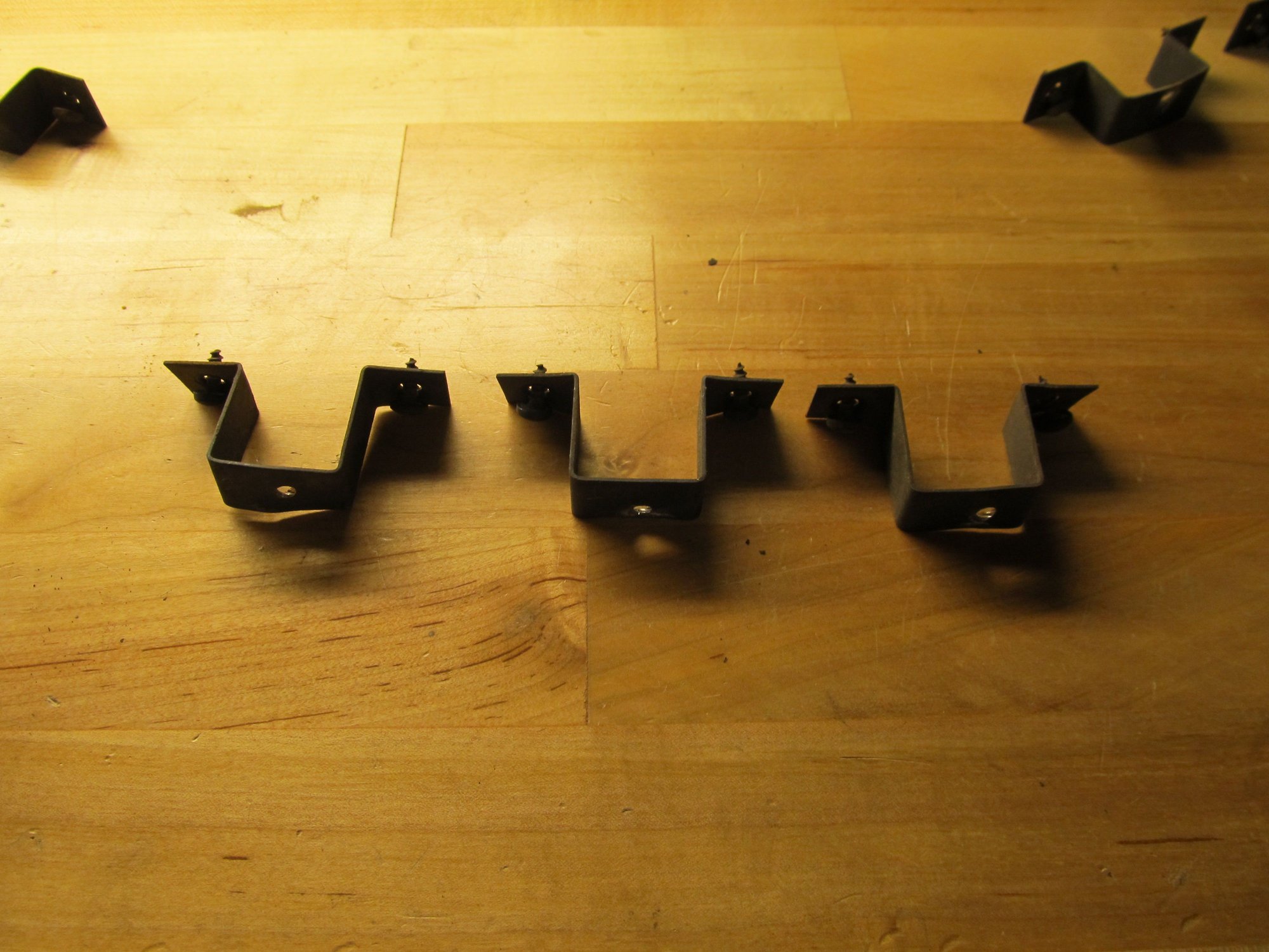

Try this. The interior shot shows the brackets mounted, the bench shots show the brackets oriented as they came off the car.
pass side brackets
drivers side brackets
rear panel brackets (up near glass)
pass side brackets laid out
drivers side laid out
rear panel brackets

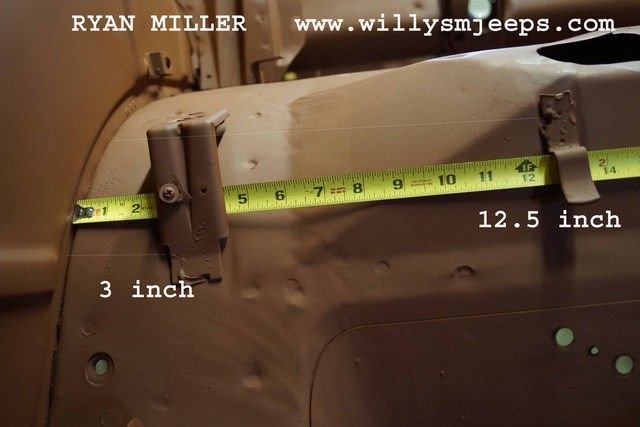

I can't see your pic - there's something wrong with my account, it looks like. Maybe this is what you're looking for? (this one isn't my pic)

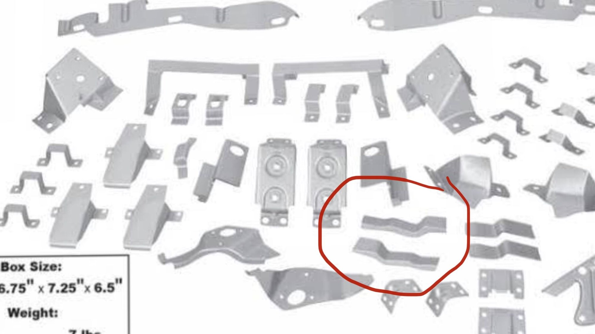

I know its an old post, but does anyone know where do the brackets below circled in red go? I have figured out the rest of them but I cannot find pictures anywhere for these 2 brackets. There is a screw hole at the end for each bracket. This is for 67 mustang fastback with fold down seat. Thanks a lot for the help
