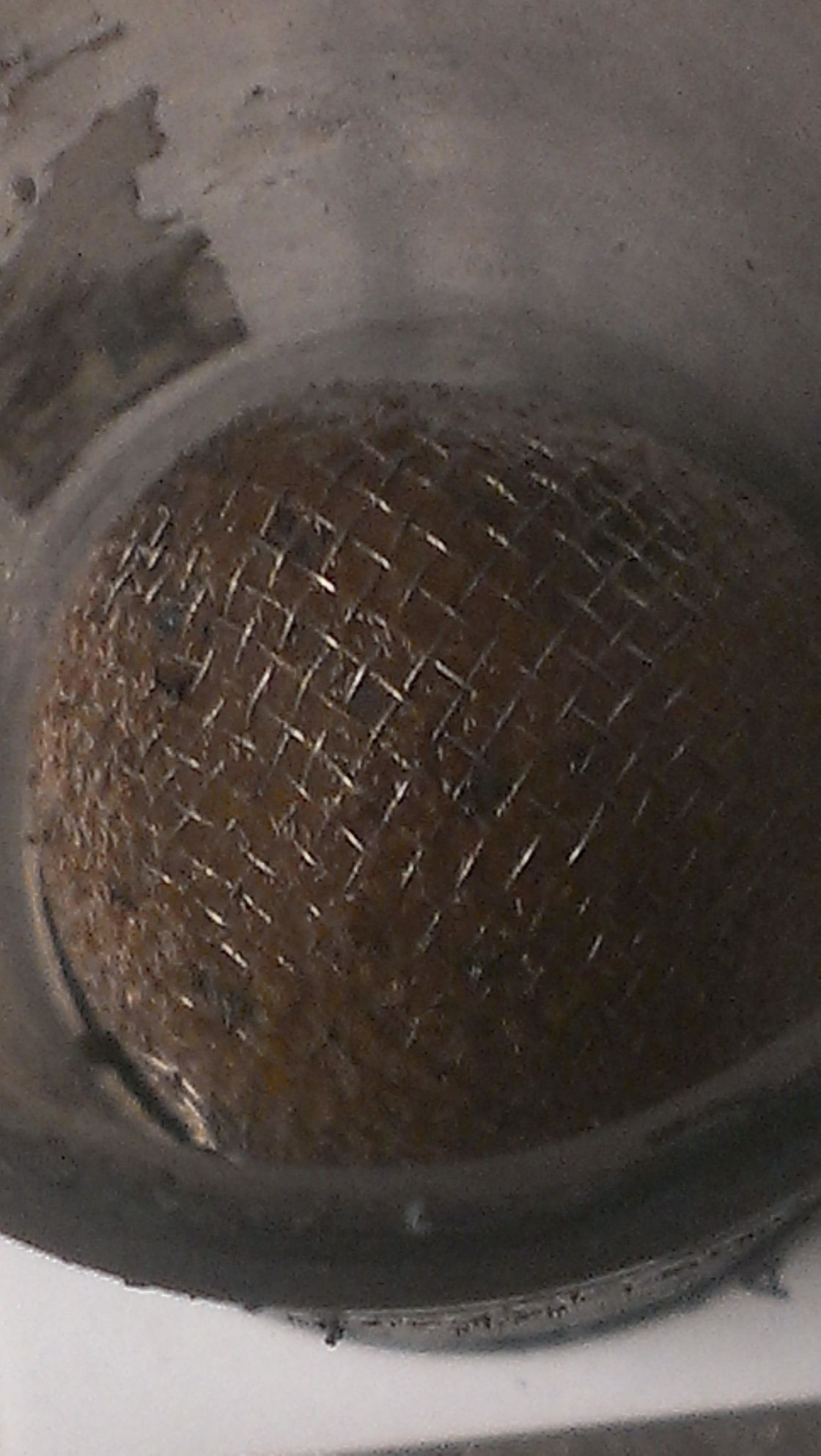

Well, the wife and I took a little trip to Vegas (I tried to win the Dodge Hellcat... no dice...) so I haven't had a chance until today to work on the car.
I drained the rad and this is what the gano looked like.
I'm starting the process Barnett described for flushing the system. This engine hasn't been opened since the 70s so who knows how much rust is in there...

see...we're right once in a while [all the time].
you can also go to the hardware store and buy oxalic acid [wood bleach] in powdered form and mix 1/8 cup per each gallon of water and drive around with that . . it will work better in your case . . flush your system twice with plain water first.
if you get a ton of rust out, do the same process again.
after you are done, rinse it out and spray water on the drained fluid to dilute it . . then dissolve 1/4 cup of baking soda in warm water and put it in the rad and fill it up and run it for 5 minutes then flush it out and you are done.
ok, i hope you put the gano in the top hose . . it is also clear so you should be able to see it when it gets dirty.
It's tough to see when there is coolant in the system but I'll keep an eye on it.

It has only had heating problems when on the highway and I haven't tested it there yet. I'm still in the overall process. So far I've:
1. Drained the system (and cleaned the gano)
2. Refilled with water and ran it on idle for about 15min
3. Drained it again (water was orange)
4. While still warm, I put in a bottle of "Blue Devil" from O'Reilys. I'm sure it's no where near as good as the citric from MB or some CLR, but for today it was what I had on hand.
5. Added water to the "Blue Devil" then drove it around for about 25min.
I plan to drive it a bit more, then drain it and run water through it again and then repeat with some MB citric, then maybe some CLR. I expect I'll be repeating this several times, trying to get this thing cleared out.
