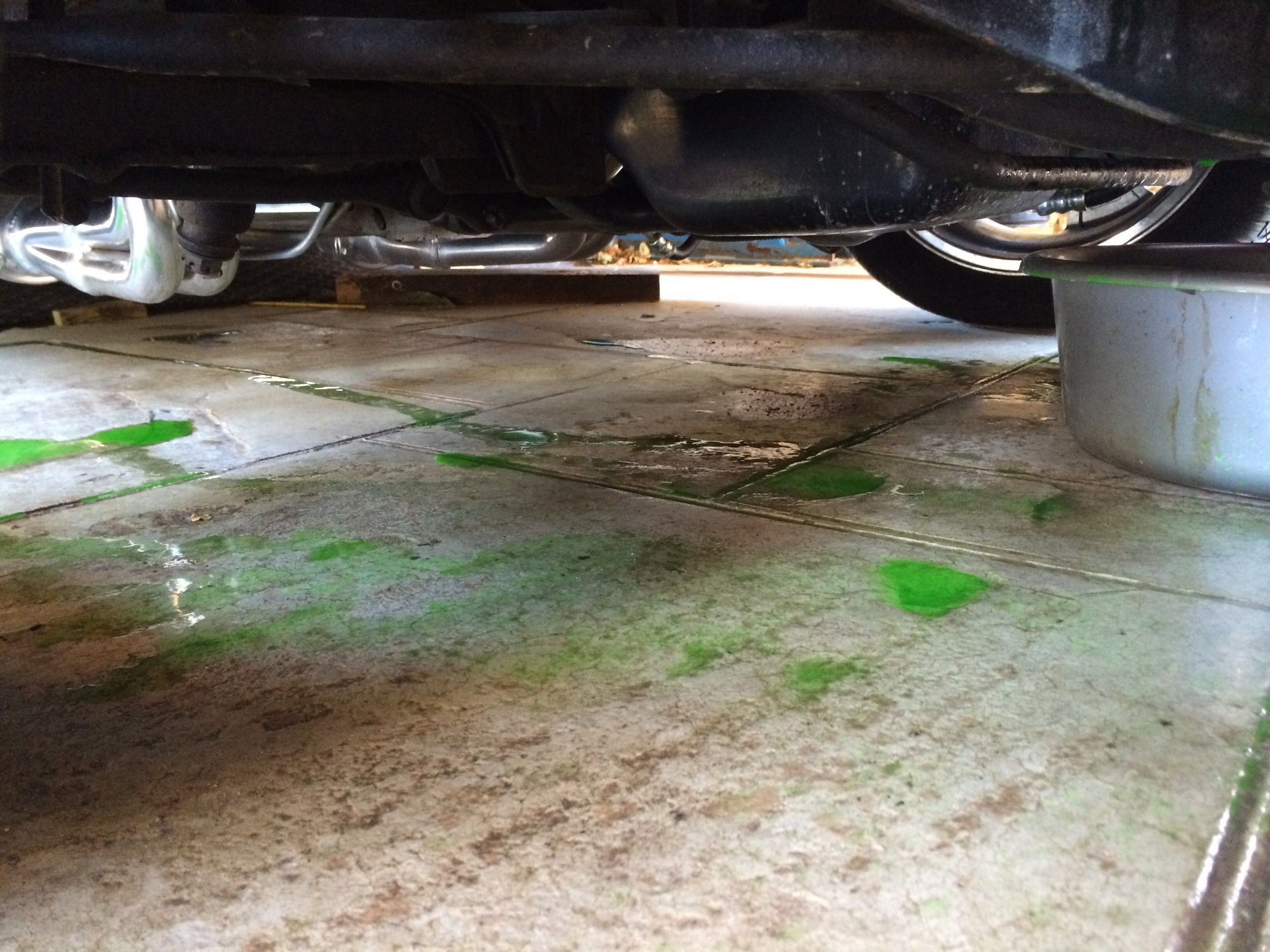

Ok so I don't get a bubbling in the radiator until about 150 degrees and i wouldnt say small constant bubbling, just every minute or two it'll boil over the radiator and an occasional popping up of water.
And I am not sure the engine overheats as I havent actually let it run up to 180-190 as at that point the noise will have already started and the coolant already making a mess on my floor.
Before I parked the car 3 years ago it ran ok. Engine was jumpy ( could have been spark plugs ) but never a prob with overflowing coolant and noise until now. As said before I have since then changed the transmission, torque conv, radiator, put an oil cooler, and other minor things but nothing to the engine.
All the plugs were same, carbon fouled and few smelled of gas. Perhaps the ones with the weak spark. That would cause the gas to seap down into the oil causing the smell of gas into the oil. But still the noise baffles me and have to wait for my sparks to try anything else .
I am hoping the knocking is the combustion or non combustion of the non firing sparks and the coolant is an air pocket?

Bottom hose is fine entire time. It doesn't compress.
My water pump is literally brand new. I installed it before the car sat. I only use anti freeze at the exact mixture so it can't be rusted. Besides when i rev the engine before it warms up I see the water level go up and down which means it's working.
I installed the new sparks and managed to tune the engine but once it warms up the knocking noise begins. once the noise starts then I get the overflowing of the coolant. First knocking then immediately after the overdlowing. And it's around the cylinder number 3-4.
What shall I do now? I have ordered a fel pro gasket kit to be on the safe side. I'm assuming when engine warms up the cylinder leaks out gas from the chamber into the water passage. Knocking noise could be water mixing with the hot gasses? Or water seeping into the cylinder?
What a freakin mess!!!
