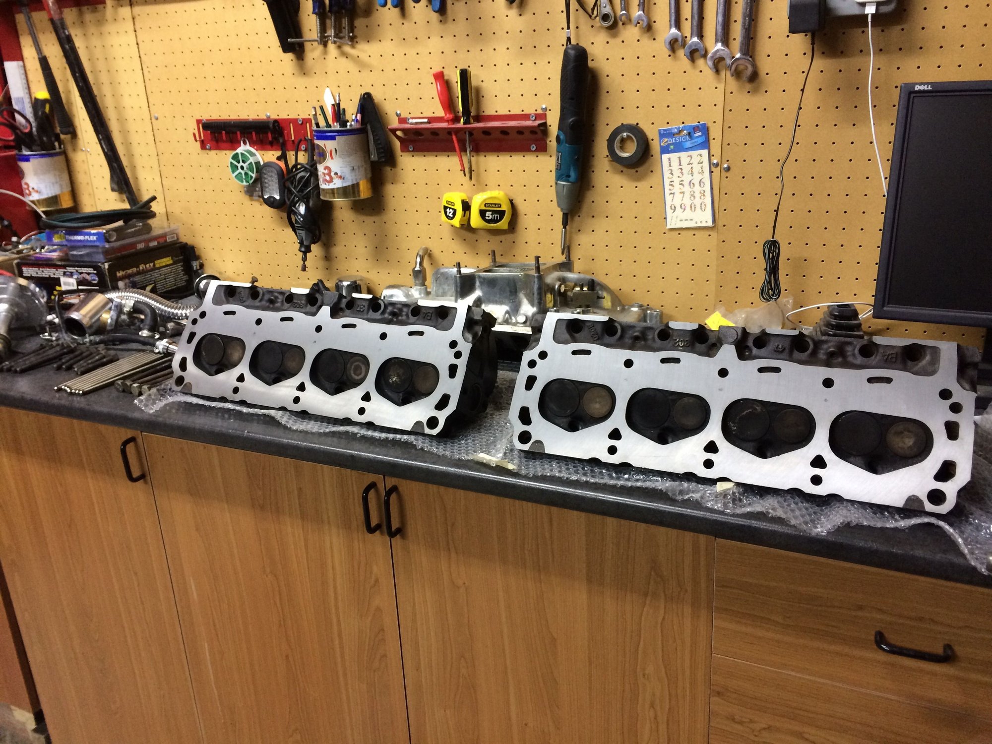

Not bad, it's now 9pm, this time yesterday I started taking things apart and now I'm ready for the rebuild. First I have to clean up all the silicone beading and old gasket stuck all over the place. Any recommendations on what to use to get them off? I have 80grit sandpaper that ill use to smooth it out after its almost clean but what would you recommend?
And also gotta clean the coolant out of the block and make sure there is no gook left behind. Any recommendations here??
Also what would you put in the cylinders to avoid getting them dirty? I was thinking a balloon slightly inflated and to rub it a bit with oil to get it sticky..
Then I'm pretty much all ready to rebuild. I had the heads Vaccum tested and pressure tested and they are good. Number 7cyl exhaust valve was a bit whitish so my leak was around there somewhere.

The only times I've come across gook like that is when two types of incompatible antifreeze are mixed together or there was oil mixed in... with the coolants specifically the Dexcool (GM orange stuff) with run of the mill green anti-freeze. Not to say other combinations of stuff couldn't cause that but what do you think caused the goo to form?

also, was there gunk in any of the head gasket ports?
we need the part numbers off your heads.
we need your engine size.
i would not cut the heads until we have that info.
also they must measure the heads for flatness to see if that is your problem.
i would spray carb cleaner in one bank of ports in the head at a time and see if it weeps out around the valves.
i would have aslo had them magged for extra insurance.
yeah, just shop vac the coolant or use paper towels . . change the oil with oil with zddp if you have a non roller cam, then run it a few minutes then change the oil and filter.

Now that you mentioned it, I did once top up with blue antifreeze. I never knew it mattered but what i think mainly caused it is the hard water in this country. Has a lot of calcification and at those two spots I have temp guage hooked up so it's not 100% clear passage. Plus car sitting 3 years with pretty cool winters and 100+ summers. Whatever it is, it's almost gone and tomorrow I'll finish cleaning everything up and Friday put her all back together
