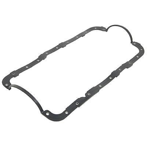

The oil pan gasket for those have, four pieces? Two for the sides, and one for the
front and the back, right? If the oil pan was hit, and pulled just a tad in either direction,
those won't seal 100% depending on how much the pan was bent or warped. SO, they
leak from the front or rear gasket or between where they meet the side pieces... I
hate those... There should be an aftermarket 1 piece so there are no gaps between
each gasket piece. Yeah, there is a neoprene one piece...
And not this:
That is a felpro...
And not this:
That is a felpro...
One piece is always better than non-one piece, this includes the rear main. Felpro does offer an HP version of the 351W oil pan gasket, it's a one-piece.
The only reason to do a main two piece is you don't want to have to separate the trans/engine. The problem with the convenience part of it is that in most cases your main will still seep or it won't last long as a two piece.
