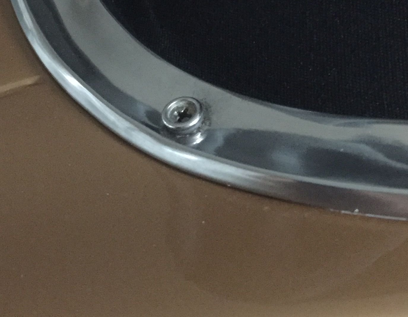

I don't know for sure that yours is the same as a 67, but either way I can't see how nuts are on the top side. Have a hunch, someone took the easy way out😖😖
the photo is from a 67 and inside the snap is a Phillips head in case you can't see it in the photo.
Those will probably be a pain to change too!!
sorry for the bad news
Don

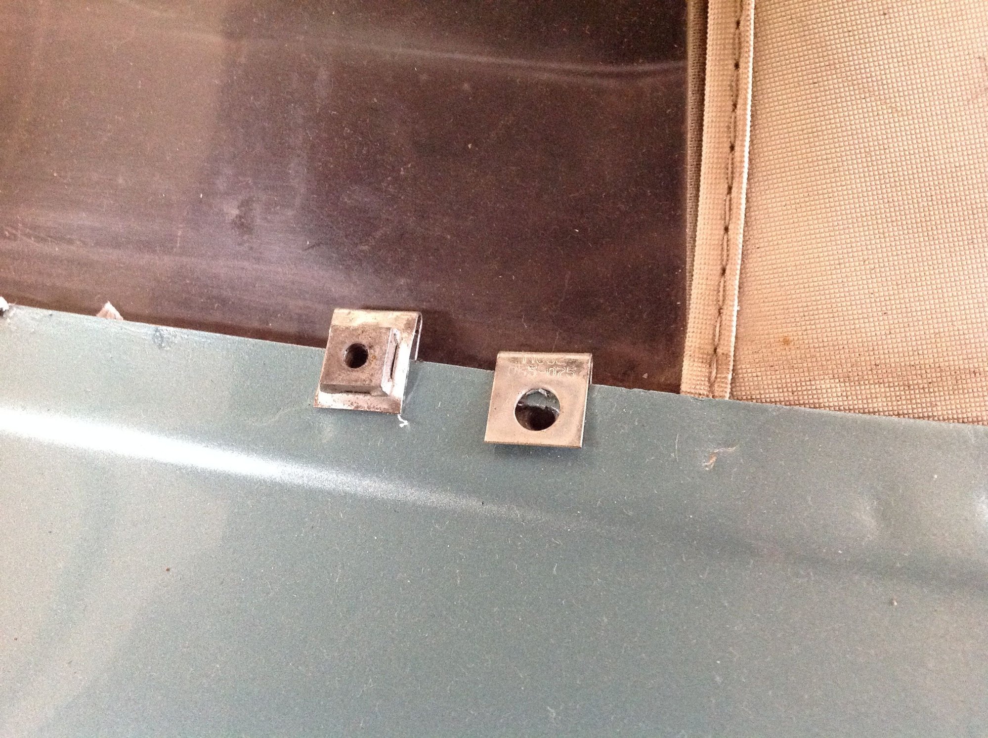

Here is a pic,the left one is how it was installed,one on the right I think is how it is supposed to be,trim was off the body1/8-3/32.henry wasn't this stupid,

I agree with you, the nut needs to be at the back/ on the bottom. Actually if you thin about it, if it was installed upside down, the trim would hardly be attached to the trunk lid, those fasteres are designed to pinch the surface for strength , when upside down only the half without the nut is holding it to the lid. Don't understand how that could have happened😖😖

It was redone some time back,the snaps are to short if installed correct,thanks for your troubles,just checking for sure
