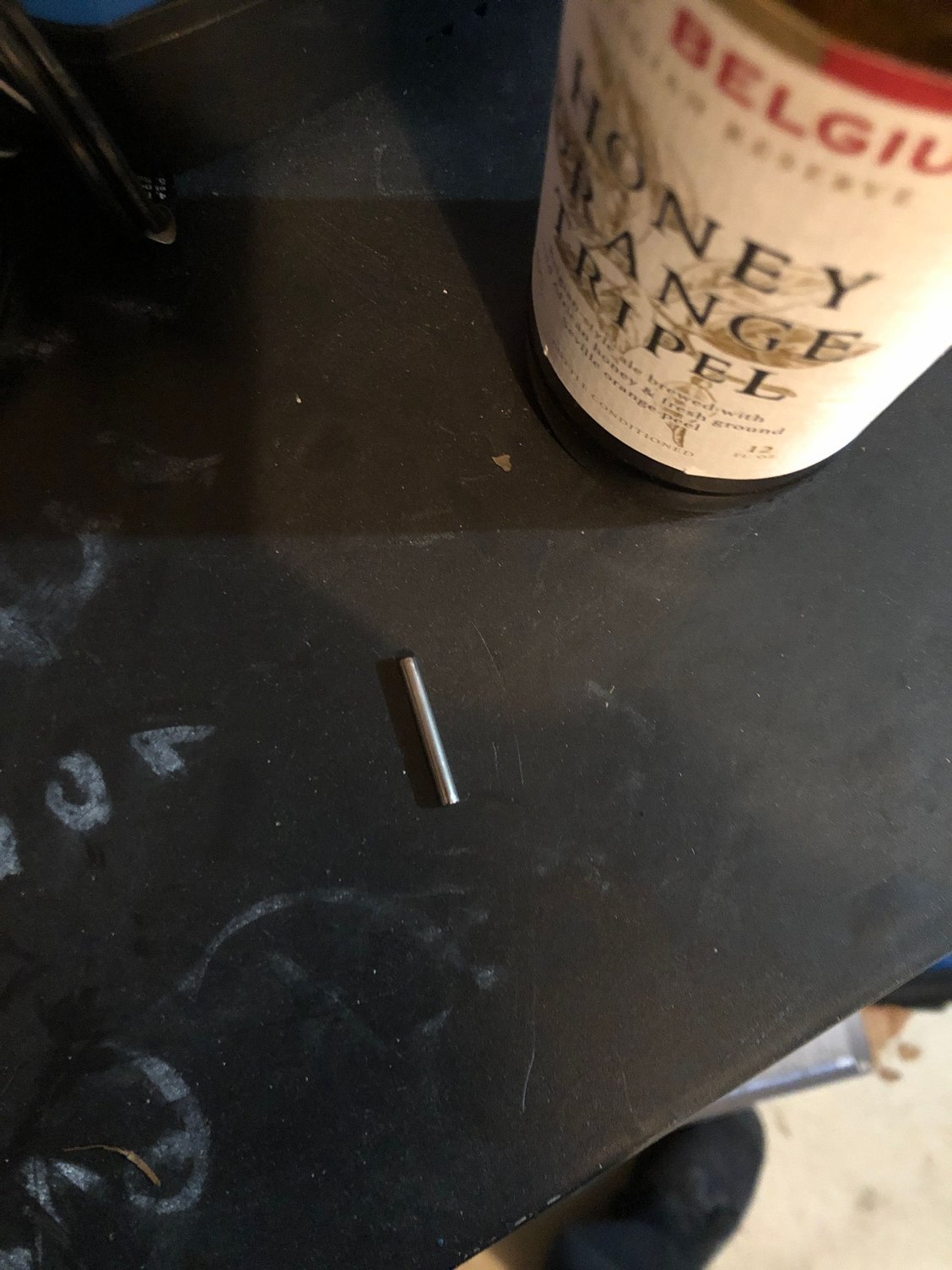

As for the steering, that little bar lock fell out of the control valve, so I'm guessing that it's shimmied itself to a point that doesn't allow fluid to flow through the valve. I'll pull the stang into the garage this weekend and do some tinkering. It's our second car at the moment, so I've got to have it figured out by Monday.

must’ve had 1 to many and left it out. So control valve probably worked itself loose and doesn’t get the movement it needs to regulate the fluid. Guess i got to pull this back apart and get it in there. I’m not 100% but the old one may be half stuck in there. Guess I’ll throw the drill battery on the charger...... all good though, can’t wait to drive this girl.
anybody know if this would’ve burnt up the control valve? Should I go ahead and order another one now?? Lol....
Don't think you need to worry about burning it up. Not that kind of setup. Get it all put back together, with no extra parts👍, and it will be fine. I think leaks are always a battle on these old systems too.
