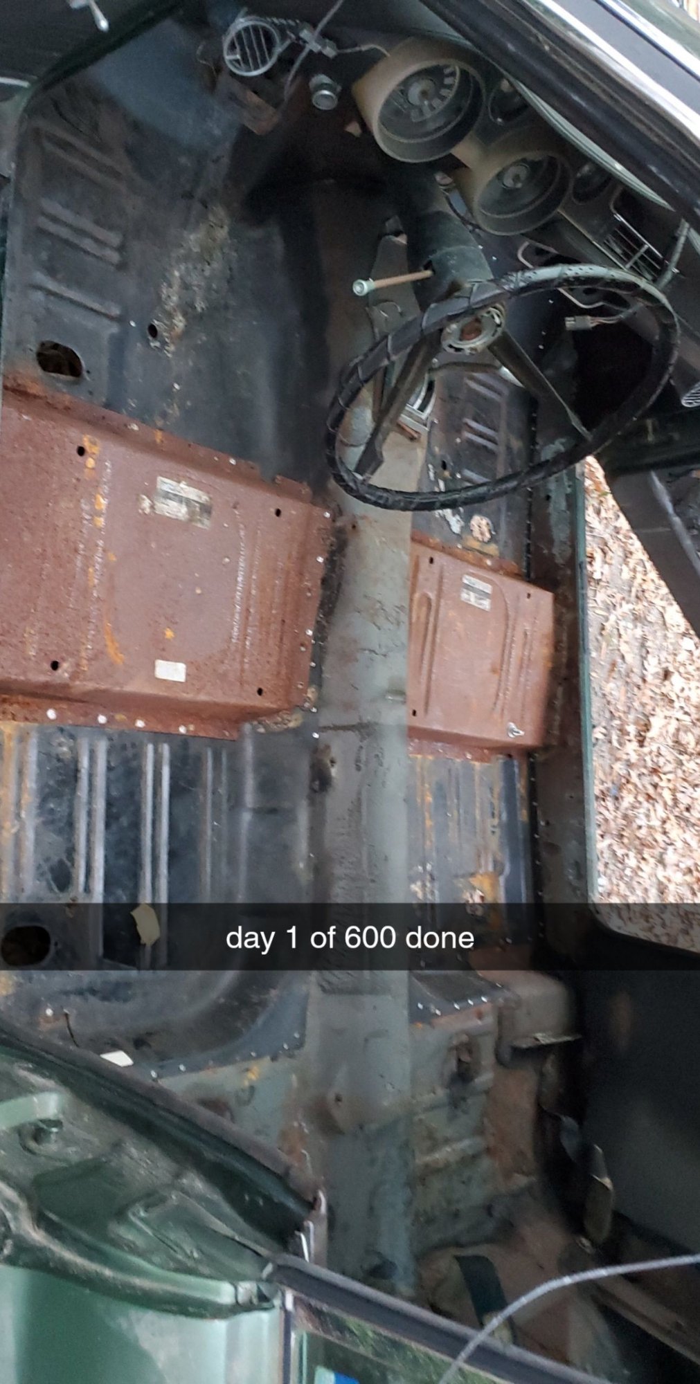

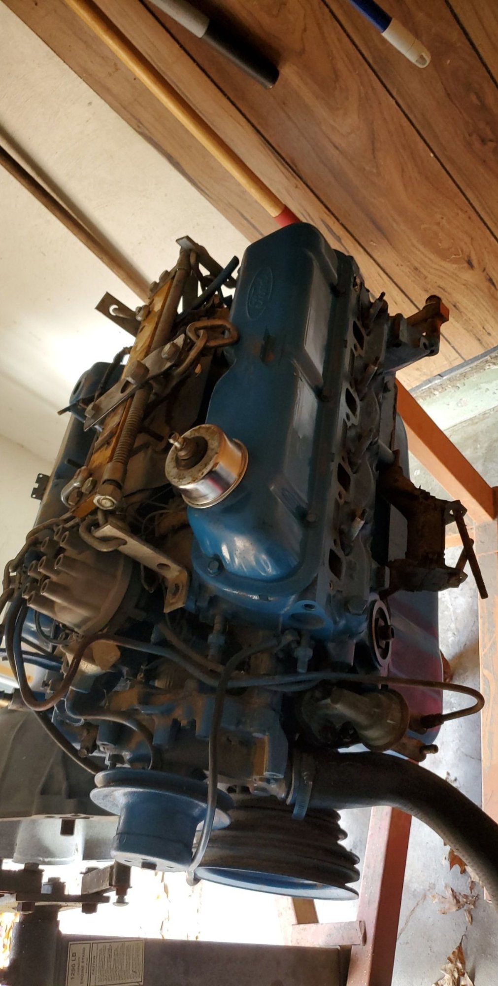

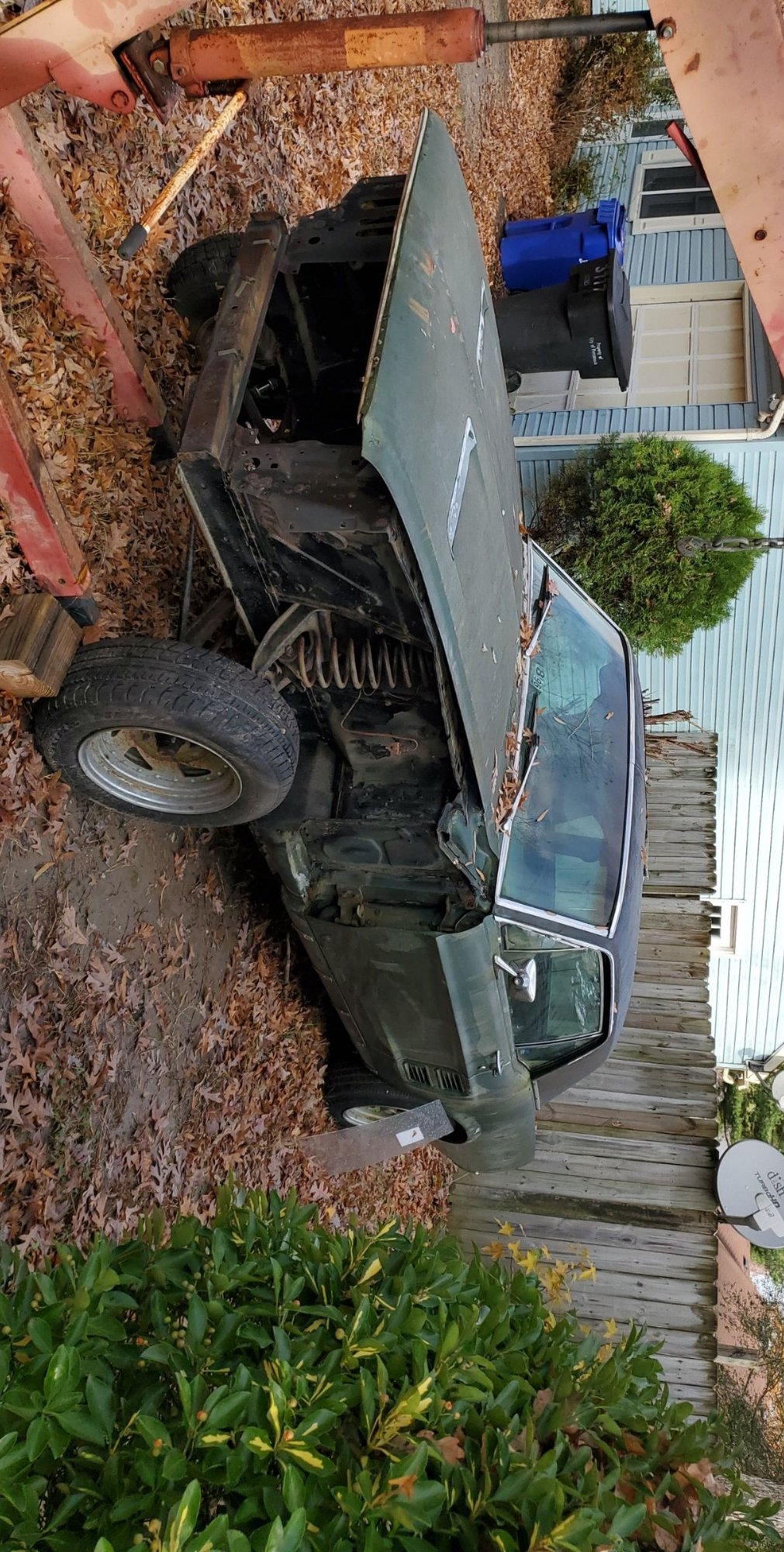

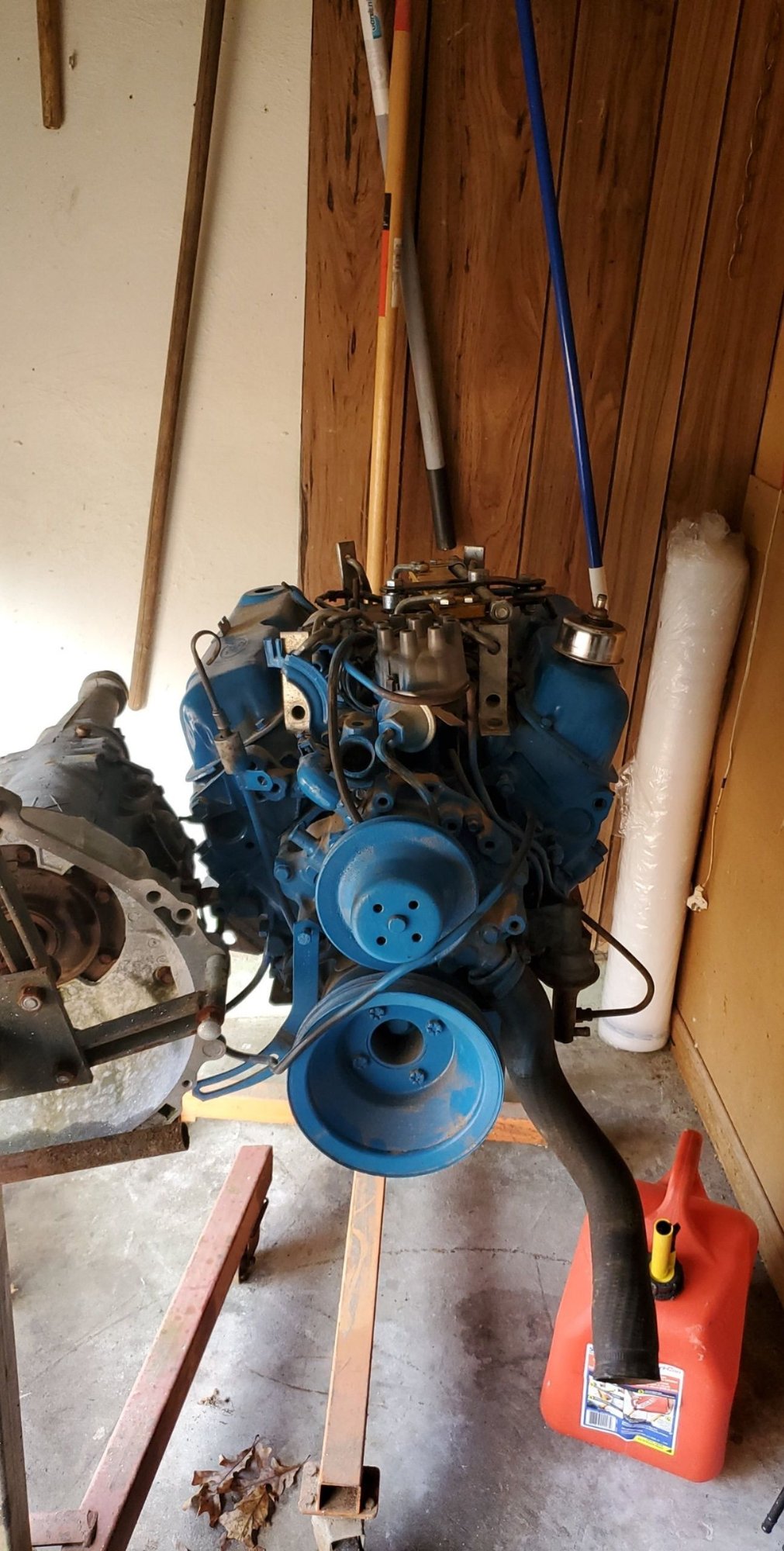

Good Afternoon , I just purchased a 67 coupe. orginally 6cyl but now has a 302 and think not sure how to tell. what year or if it's a 289. so I honestly dont know where to start or what to do. I use to be a general mechanic for about 2yrs so I have a good idea and knowledge and I been reading around and cant seem to find an answer. I want to convert from drum to disk brakes , I have a few pick and pulls around me but not sure which cars will bolt on . I read that a granada 77-79 will .but is there anymore cars? rumor is aerostar/ rangers/ explorers/ and 79+ mustangs front disk will work? does anyone know of this is true ?
also I picked up a t5 from a 98 V6 mustang. anyone know what kind of mods or flywheel / clucht il need. and I've heard I can get the read end out of a 95-99 explorer is this true as well?
