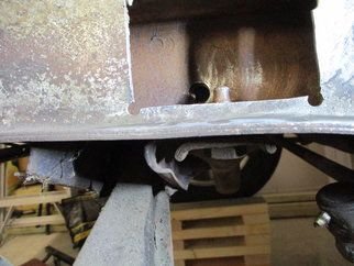

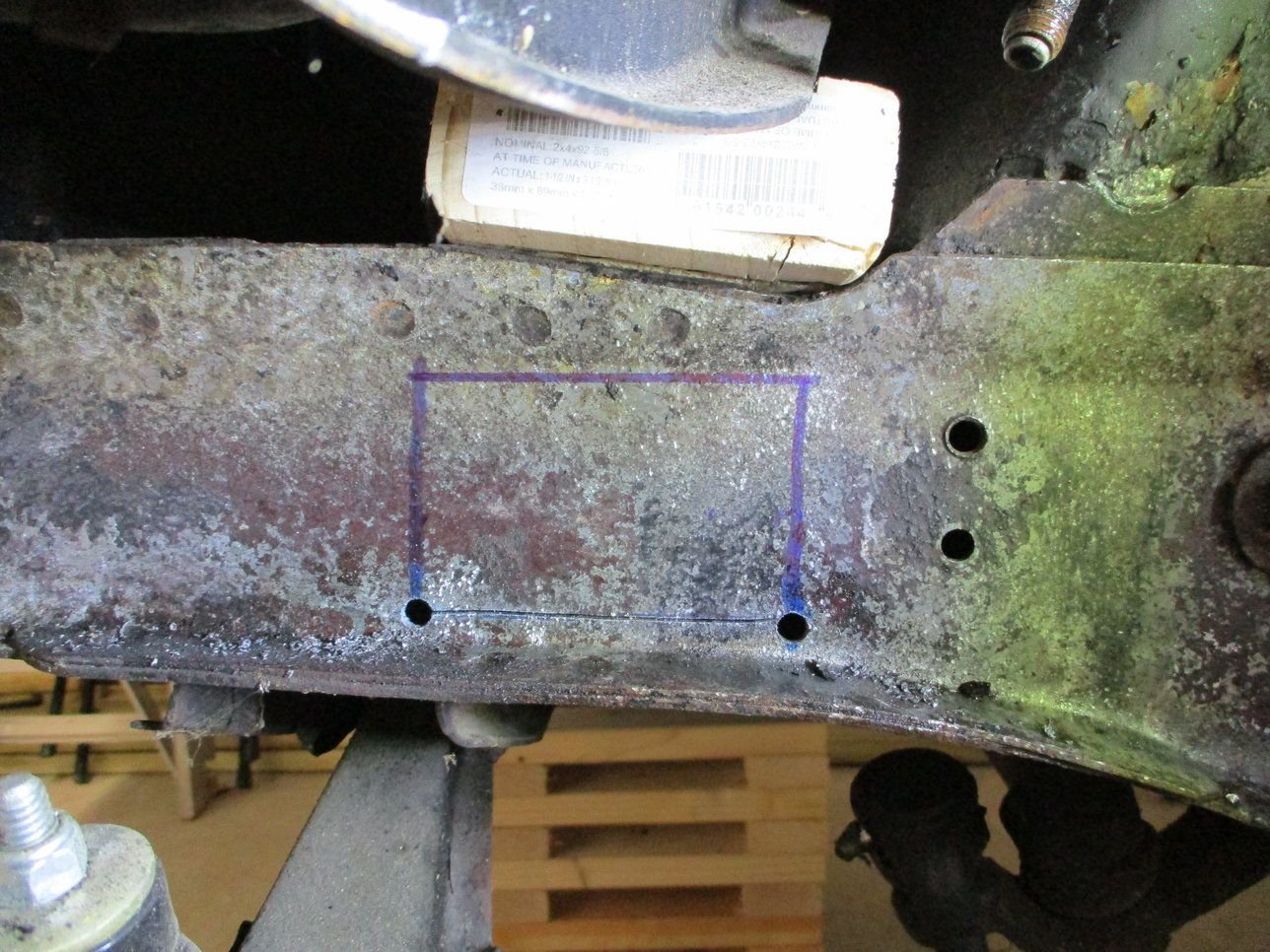

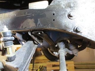

If it will make 2 turns keep soaking it with penetrating oil and turning a little at a time, auto trans fluid works great also. My bolt was broke to far into the frame rail to weld to and using a left hand drill bit didn't get it out also. After working at it for a month with no luck I decided to cut out a section of the outer frame rail.

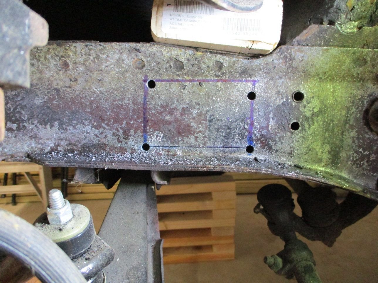

Marked section to cut
Drilled pilot holes

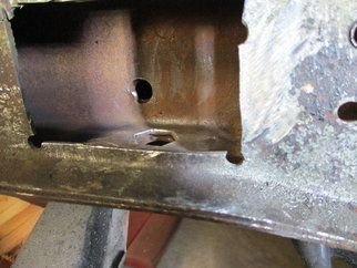

Final cut out
This is where I finished up today, will get back on it tomorrow.

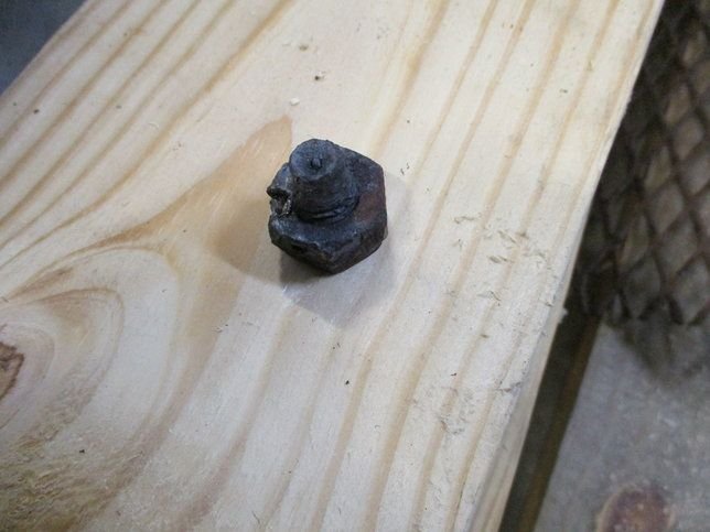

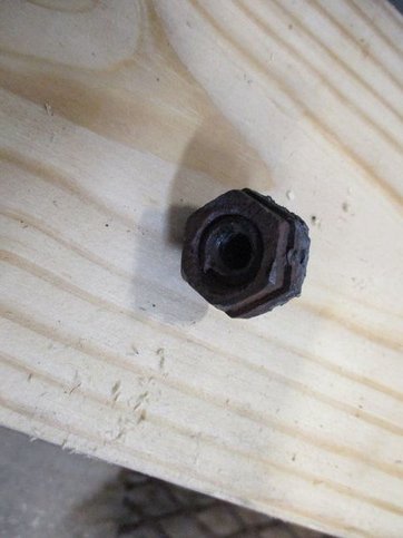

Worked on getting the bolt out using some heat and a little help with a air hammer/chisel. Finally got it out without any damage to the frame rail, so it's off the tractor supply for a few nuts and bolts.

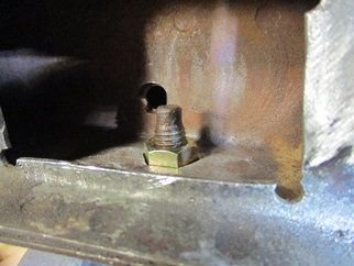

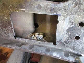

While waiting on the new cross member bolts to come in I test mounted the cross member with the bolt from the other side to determine the best way to attach the nut to the frame rail, with the nut on top of a washer or in the pocket. After trying to mount it with the nut on top of the washer and the nut in the pocket of the frame rail it appears that mounting it in the pocket is the best option.
Now, just waiting to the new bolts to arrive.

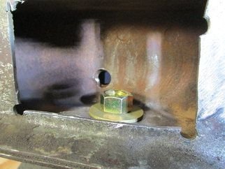

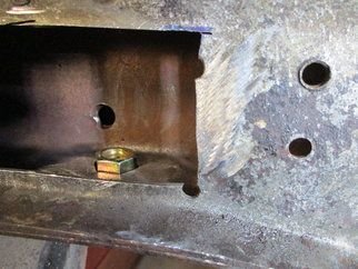

Well I got my engine cross member bolts in last week and mounted the cross member before welding the nut in to be sure everything was a good fit.
After installing the cross member welded the nut to the frame rail
Removed the bolt and put a good coat of never seize on it and reinstalled. It's not the prettiest weld but I torqued it to 50 ft lbs. several times before a final torque of 60 ft lbs with no problems or breaks. After welding the plate back in.
