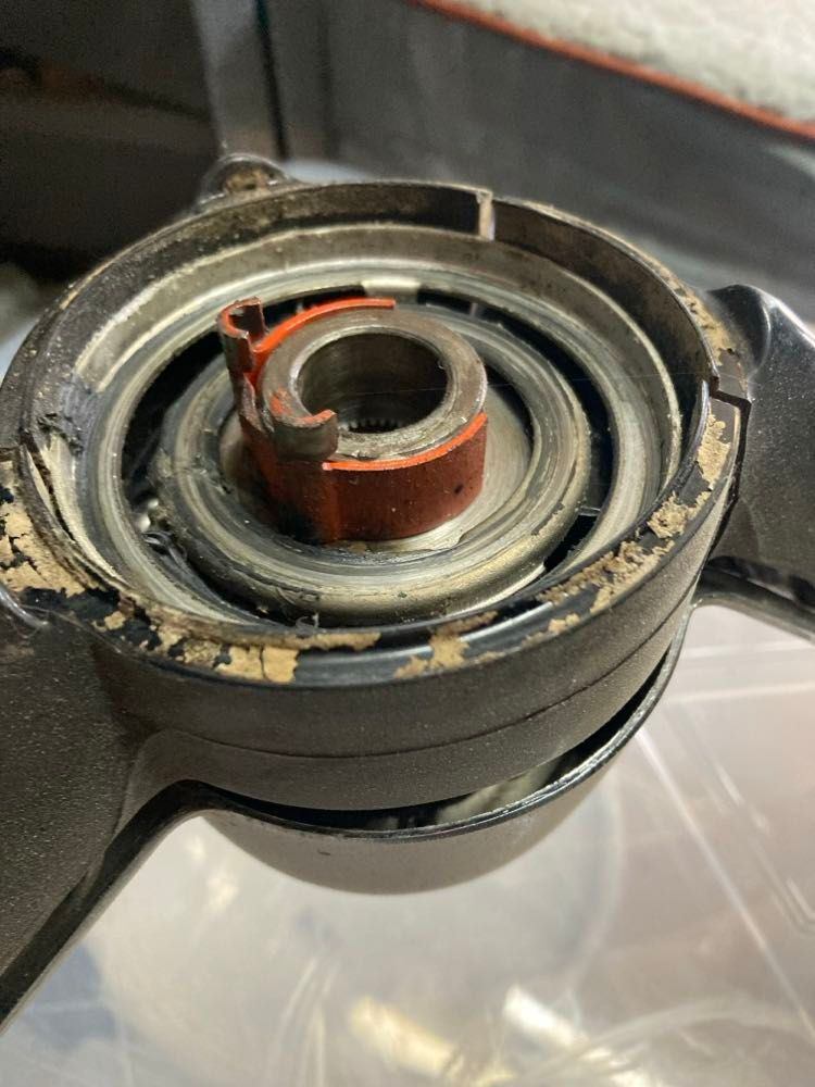

The turn signal will not cancel out after I turn. I pulled the steering wheel as I thought the turn signal switch might be my issue, but the turn signal switch is in great shape,
Any suggestions on what else might be the cause for the signal not canceling out after I turn.

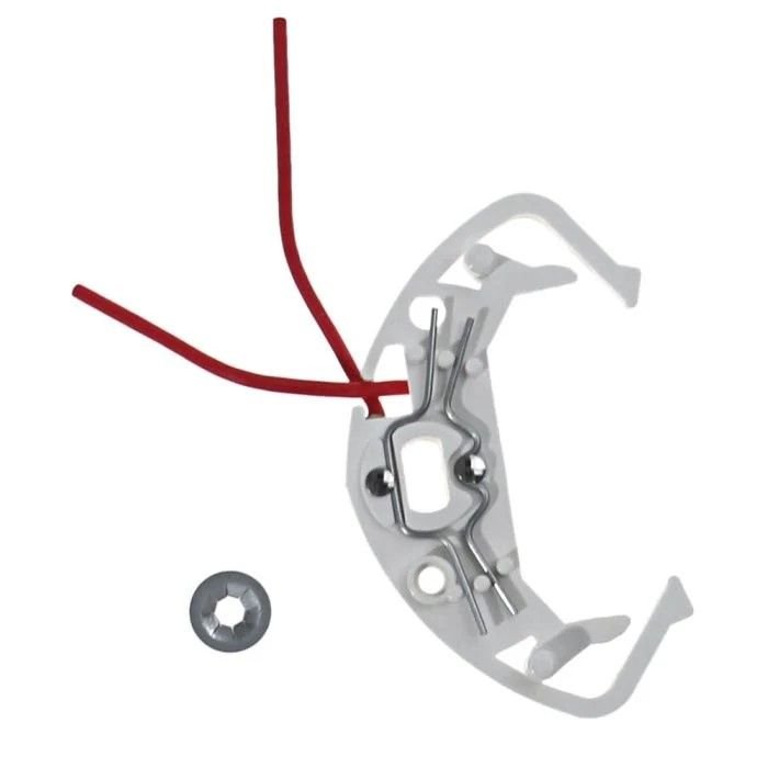

Usually it is broken outer nylon arms on the switch. The arms that do the cancelling are the outer long ones.
Other than that, maybe you're missing the canceller on the steering wheel (orange on my old steering wheel).
Not much else can go wrong.

Thanks . Mostang66 Looks like it is the canceller. Never paid attention to if it was there. Just looked and it is missing. Need to replace the steering wheel so hopefully the new one will have a cancelled with it.
