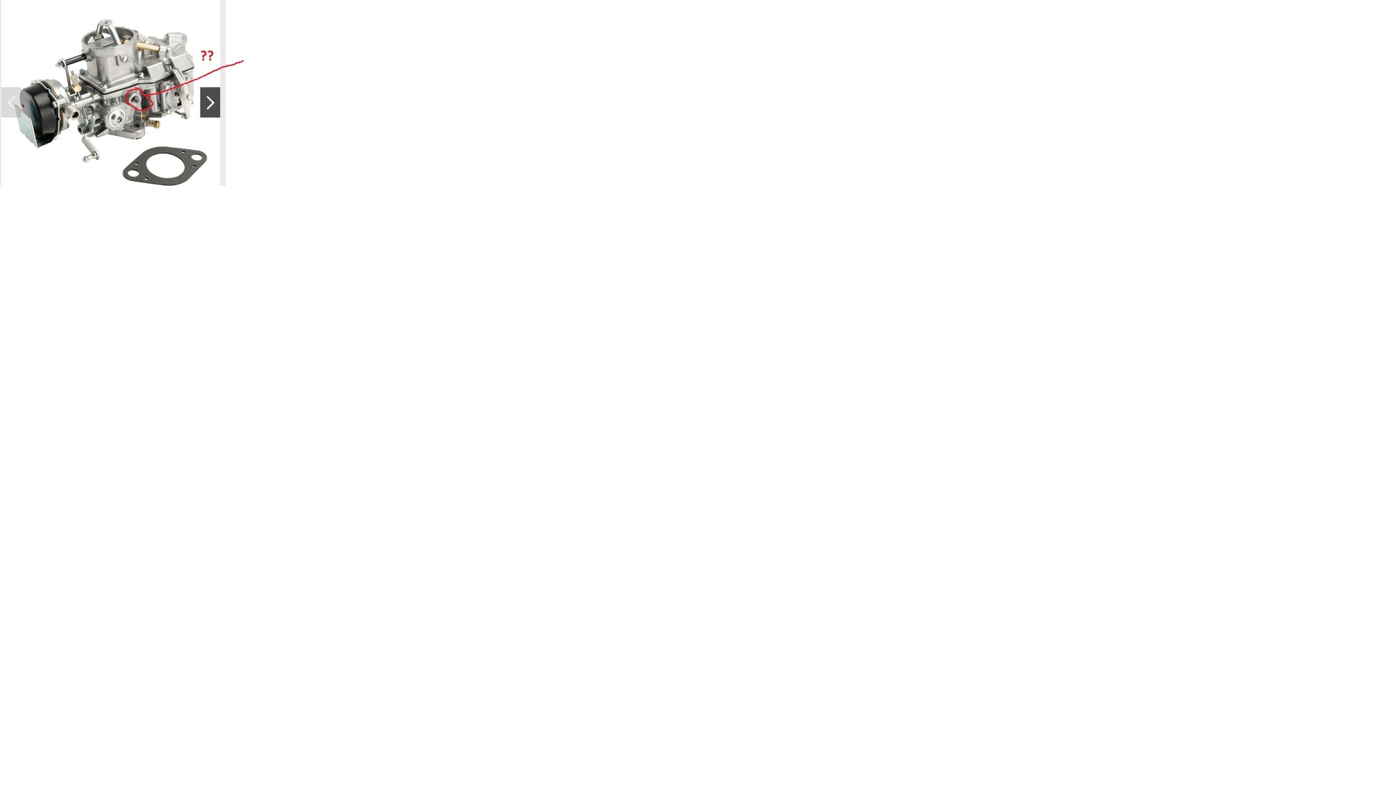

My brother is planning to use a 1100 on his old military vehicle. What is the side port for?? Thnx

if that's in the throat of carb, that would be a vacuum port for like a gauge, brake booster or other device that needs a vacuum source. If you don't need it, block it off with a brass plug and Teflon tape.
