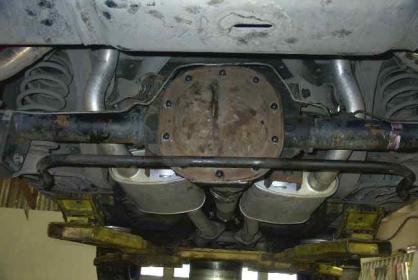

Actually, they do have a vent. Thats what holds the distribution block for the brake lines.
You'll need friction modifier as well as gear oil. Trac loc in all the mustangs.
