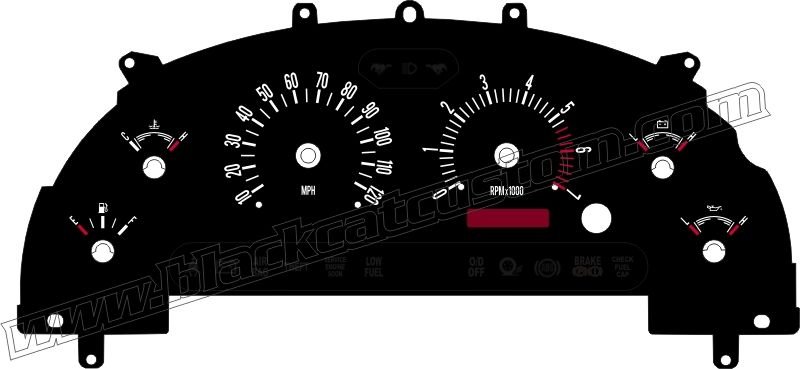

this?

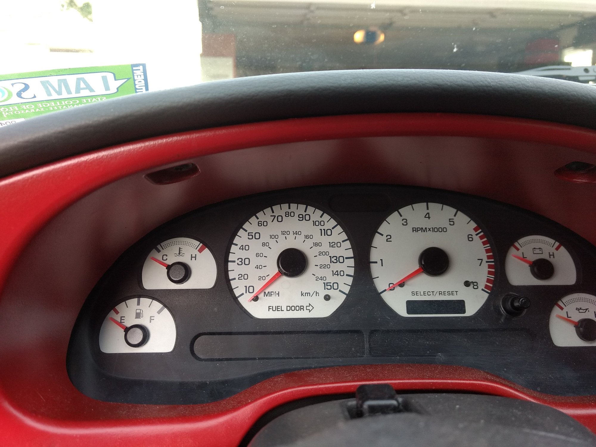

Mine should have that in it. This is what is in it.

Yeah that looks like its from a GT with the red line at 5800 and the speedo topping at 150. That's probably a cluster unit from a GT with white faced overlay (aftermarket).
Is the speedometer accurate? Because if it is then changing the overlay won't be accurate anymore. The position of the needle at 80mph on the GT is different than 80mph on the sixxer.
Is your car an auto? Just curious where it shifts (if auto).

The speedometer is not accurate. It is of by 20 some mph. Yes, it is an automatic.

Just find an overlay for a V6 car and you should be good.
