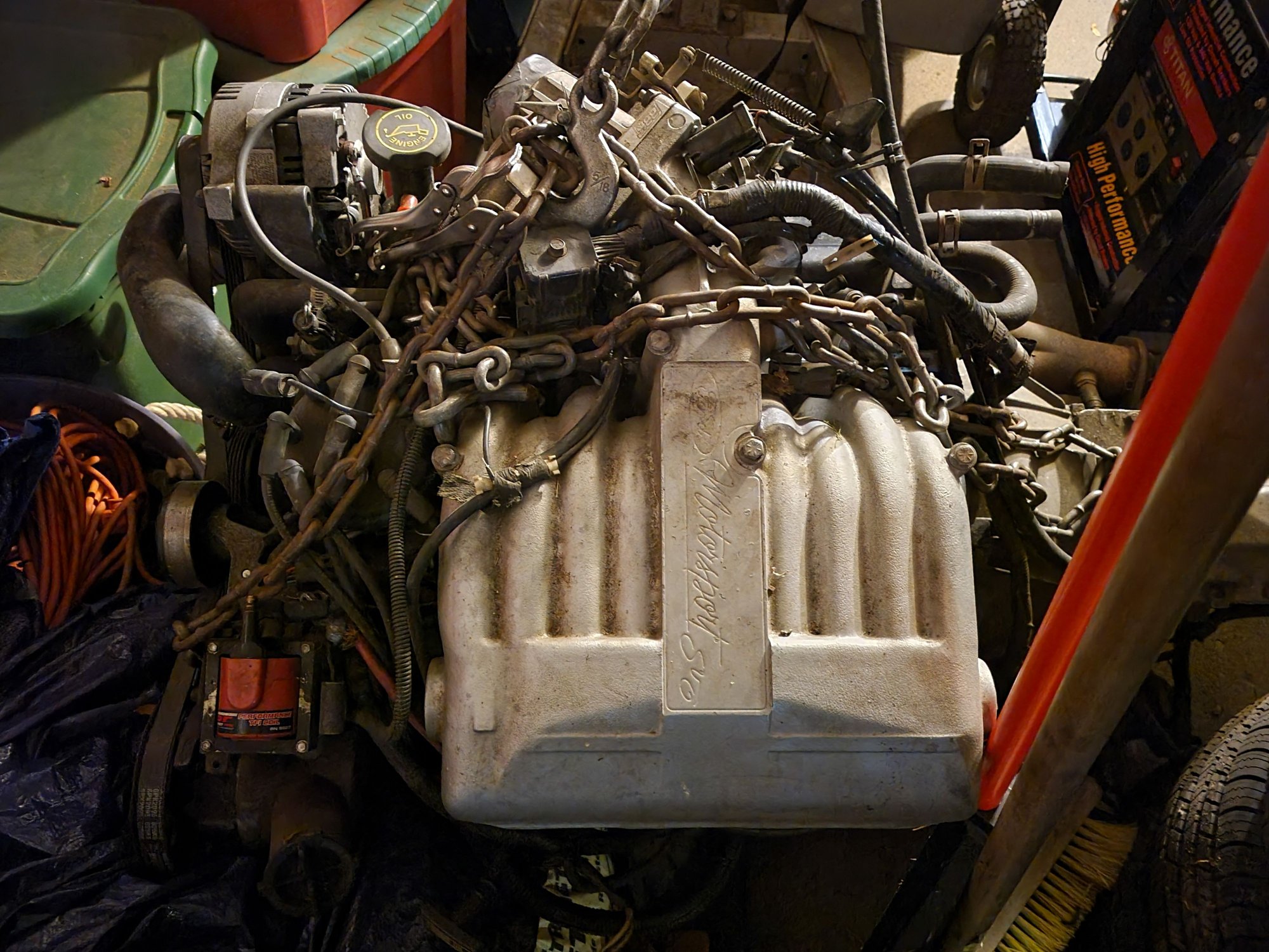

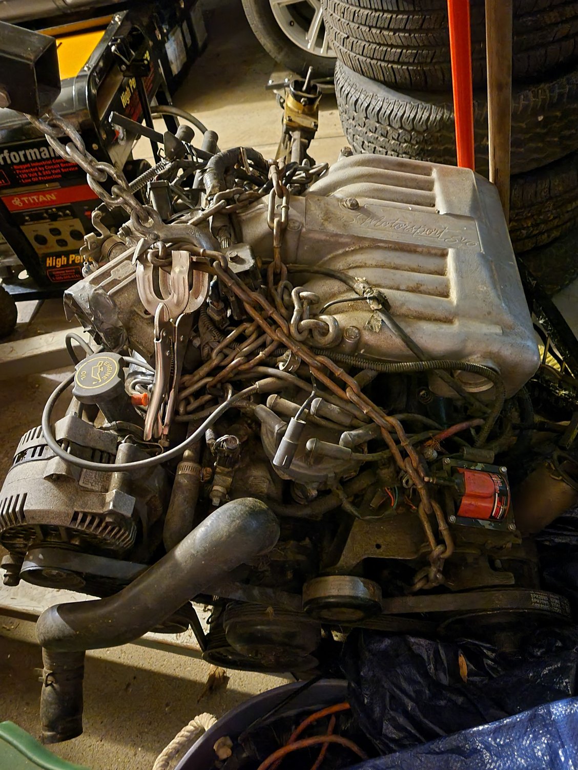

Can anyone help me identify this engine I bought. I am putting it in a 1966. It says SVO on the intake and cobra on the valve cover. It came out of a wrecked 1996 Mustang. Thanks for the help. I can't find any numbers on the block, but the intake says RF-F8YE-9K481-8A

94/95 Mustang 302 windsor, with at least a cobra intake on it.

Welcome. As drhoward stated it appears to be a 94-95 ( 5.0l ). It has a FRRP motorsport aftermarket intake and BBK throttle body, and MSD coil. I can't see the valve covers., They probably are a cobra upgrade add on. The lower intake manifold # RF-F87E-9K461-BA and # RF-F2ZE-9K461-AA . These were sold by Ford Racing from 1998 to 2003. Good luck with your project.
