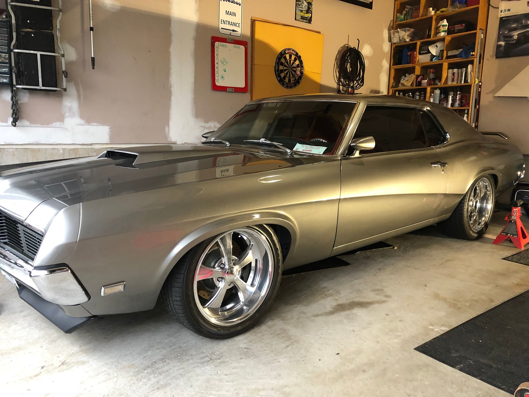

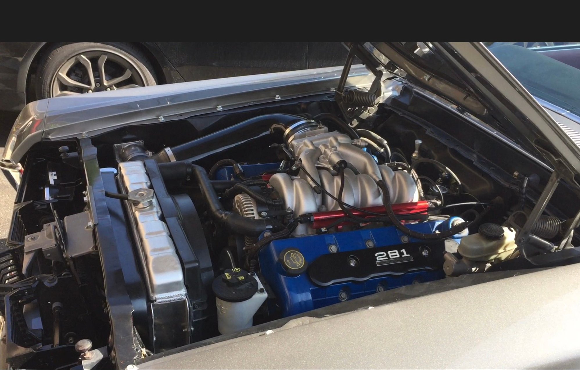

Hi, I’m new to the site. So hi everyone! I have a question that hopefully some one might have some ideas to help me out, or at least point me in the right direction. I have a pro touring 69 mercury cougar with a transplanted 4.6L DOHC out of a 98 LSC Mark 8, with 4r70w , 4 linked rear end with more..
Anyway, I am running a hydroboost from a 2000 mustang GT. The ps pump, lines and rack are all brand new, the hydroboost unit was not rebuilt. It had no apparent leaks, and was a very clean unit, so figured it would be ok. My situation is, when I apply the brakes, I get a whoosh sound. The car does stop well,
When the brakes are applied, I also find as the car is slowing, and the tranny is gearing down, I feel each gear shift in the brake pedal. Is this a sign that I still have air in the system, (I have bled the system already for about 2 hours, on 2 separate occasions), or does it mean the hydroboost itself needs to be rebuilt.
