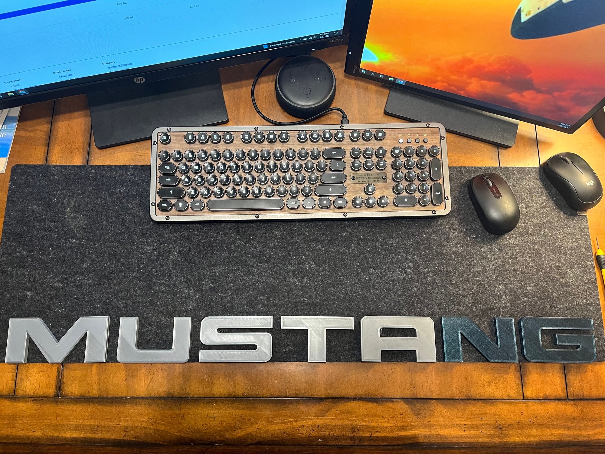

For the exterior, I’m not sure if I want to do a body kit or just keep it the way it is. Definitely going to put coilovers on it and a set of Stance SF10 wheels in the bronze color. I’ll probably customize the headlights to look more modern as well with LED tubing and an LED headlight conversion. I want to change the tail lights as well. I know I want to change the grill to a blank one because I’d like to put “MUSTANG” across the grill like the Raptors have “FORD” across the grill. I opted for Mustang because Ford went out of the way to not have any Ford badging on the car. This is a project I already started. I tried to look for anyone that has done this and it appears I’m the first that has even considered it. I don’t know how it’ll look but I hope it looks good. If not I’ll put something else in there, like V6TT in the Mustang font. I 3D printed the letters and I’m going to try 2 methods, one is copper electrolysis to copper plate the letters and the other is just simply vacuum forming ABS plastic over the 3D printed letters. Here’s a pic of the letters that I modeled on Fusion 360 after the last generation of Mustangs…don’t mind the 2 colors, I ran out of the gray color.

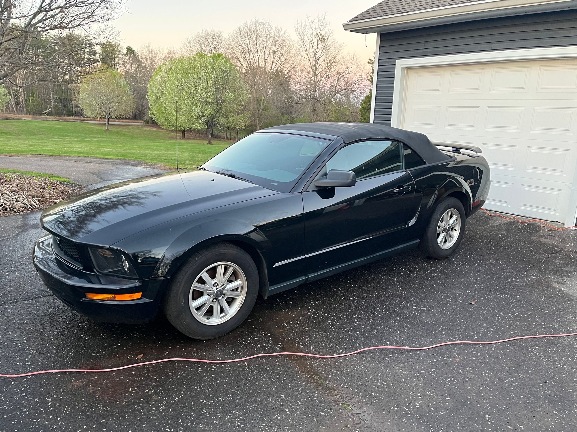

Yeah that’s what this car is. Black with black convertible top and black leather interior. Not sure how to tell if it’s the Pony package or not. I’m used to JDM cars. Never thought I’d own a Mustang but it seemed like an interesting project car so I went with it.

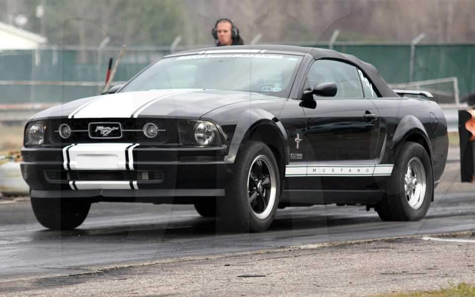

Based on the picture, that isn't a Pony. The Pony cars had the grille with the small foglights, a tri-bar on the fender, and the side stripe under the door. A few pictures of my 2006
Stock side stripe for the Pony package
Pony grille with the small foglights, and aftermarket Shelby superstripe
This is what it looked like the day it was loaded up to be transported to the new owner. Different hood with shaker scoop mounted on top of the Xcharger
Had a custom 6 point roll bar for drag racing. Once a convertible is quicker than 13.49 in the quarter-mile a roll bar is required.

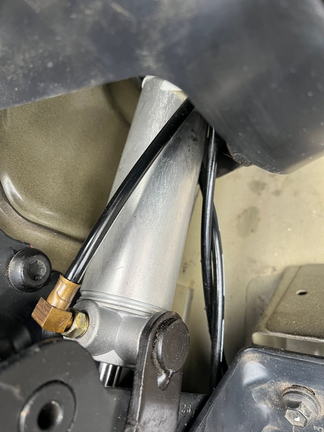

In other news, I put the top down on the car a few days ago and heard some spitting and sputtering from the passenger side. The top would not go back up. Cool, the seals on the hydraulic cylinder are bad. Ordered some new cylinders from a vendor and installed them earlier. Just have to fill the pump with ATF and it should be good to go.
For those that have not had to do it, it’s fairly easy. Remove rear plastics, 3 6mm bolts are holding in the speakers. 13 mm bolts are holding the rear back rests in, we need to remove the rear back rests because the pump is behind them. If your cylinders were leaking, you’re going to have to refill the reservoir. Remove those and then you have 4 T40 bolts holding in the cylinders. One is a holding a cover on and underneath the cover is another that goes through the piston part of the hydraulic cylinder. Then the flare nut fittings are 7/16. I used electrical tape to secure the hydraulic hoses to the cylinder so that they don’t rattle. Remember to wipe everything down real good afterward to clean up your workspace.
New hydraulic cylinder goodness.
