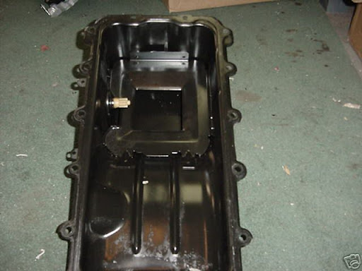

Just so there's really no confusion, even Dave doesn't think the Accusump is doing all that much for him (he did it in the name of "extra insurance"). Even our oil pan seems pretty well baffled. Slaya once showed this image of what we're working with:
You can check out that "oil viscosity" thread here.
As for the integrated oil exchanger, I think you can find info on it in the shop manual. The coolant tube runs into the block right along side the oil filter. From what it looks like, they are just running really close to one another, and as the coolant flows it's taking up heat from the oil. I'm at work so I don't have access to the manual, but I'm pretty sure it's indicated in the system components. Not sure how effective it all is, but like you said, this is probably best evaluated by the actual temps we're showing.
I do recall hearing that the 4.6 pans were well baffled. From the picture, I’d say so. The other part of the puzzle is the drainage from the heads. Given the result from the FR500S, they have “sealed engines” so teams can’t mess with them, I’d say they do well in that department too.
